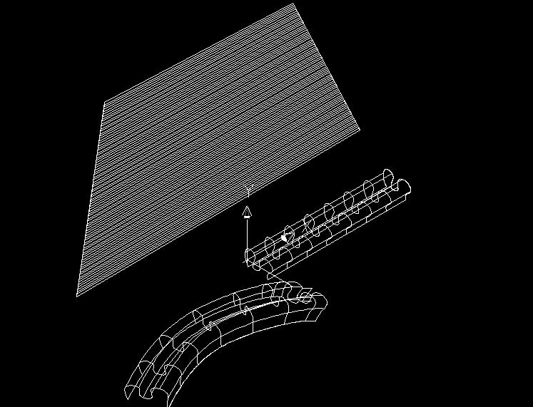

    jpeg attached. it is a very simple example, the amount of columns/ rows could 10 or 100, for eg.
    Im sure i can use you example, i just need to work out how to accept input from the command line and then work out the calculation required.
