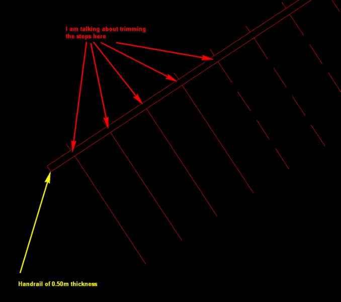

    is there a macro or variable that changes this when i mirr text?

    Not quite sure what you mean here... the sysvar is MIRRTEXT & is set to 0 or 1 depending on whether you want it to mirror or stay corrected. The image you have attatched shows MIRRTEXT off.

    Jon, is it that you would like the 1021 to still be at the top?

    the image is a muilt line attribute i need to mirr and mirr back so objects to look like image on the bottom after it was mirred.
    a macro would help alot .
    eg builing needes to be mirred and when mirred all att are upside down

    not sure if this is possible for muli line att
