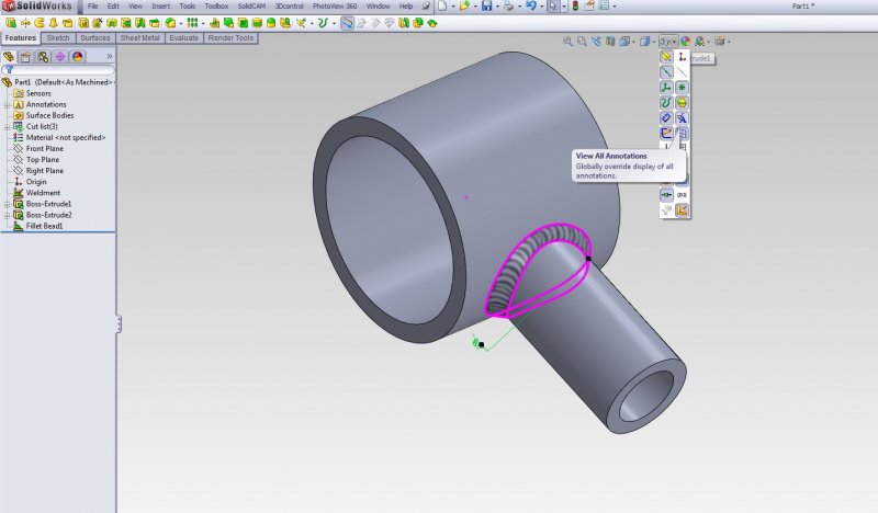

[ATTACH]10548[/ATTACH]
can someone tell me how can i correct this??
Did you use surfaces or solids? Can you attach the file here?
the file is 900kb+..i cant upload it here, and i cant post links from rapidshare :S
