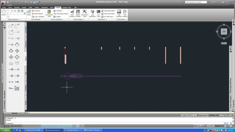

zionshea Posted January 16, 2010 Share Posted January 16, 2010 Hi all, Please see attached file and help in the following: 1. How do I bring back the menu items? 2. How do I bring bcack the ribbon tabs or pannels? 3. How do I put the command line to its old place, to the lower part ofthe screen? Thanks. Quote Link to comment Share on other sites More sharing options...
ReMark Posted January 16, 2010 Share Posted January 16, 2010 1. Menubar=1. 2. CUIload. 3. I forgot. I'll have to think on it. Quote Link to comment Share on other sites More sharing options...
ReMark Posted January 16, 2010 Share Posted January 16, 2010 3. Try pressing Ctrl+9 or go to Tools > Command line. Update: Confirmed. Ctrl+9 will hide and unhide the command line. I tried it using 2007. Quote Link to comment Share on other sites More sharing options...
Tankman Posted January 16, 2010 Share Posted January 16, 2010 3. Try pressing Ctrl+9 or go to Tools > Command line. Update: Confirmed. Ctrl+9 will hide and unhide the command line. I tried it using 2007. Does '07 use the same command line input as '09? His post says, "2009." Poster refers to '09 but his profile says, '08? Quote Link to comment Share on other sites More sharing options...
ReMark Posted January 16, 2010 Share Posted January 16, 2010 I checked 2009 as well. Ctrl+9 will work in that version as well. Quote Link to comment Share on other sites More sharing options...
BearDyugin Posted January 17, 2010 Share Posted January 17, 2010 Confirmed. Ctrl+9 will hide and unhide the command line.[/i] But it at it and so unhide, only not in that place. It is necessary to only take it and to drag downwards. If does not last it is necessary LOCKUI-> 0 to unfasten windows Quote Link to comment Share on other sites More sharing options...
zionshea Posted January 17, 2010 Author Share Posted January 17, 2010 Thanks all for your prompt answer. 1. Menubar=1, this helped - thanks. 2. CUIload, not sure what should do with this popup menu to remove the the message "The ribbon does not have any tabs or pannels currently loaded" and bring back the tabs and pannels. 3. Command line: The and the worked fine - thanks. Quote Link to comment Share on other sites More sharing options...
