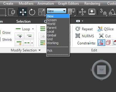

    Default Properties
    The data is on the properties box. Not sure macros run in LT, I know Lisp does not. I wonder if you can put the formula in a field.
