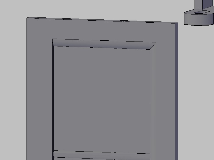

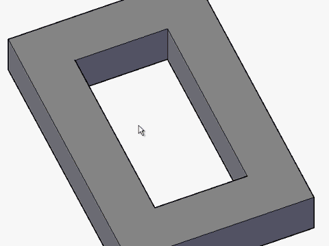

myself Posted May 29, 2010 Share Posted May 29, 2010 hello everybody, i would like to have your help trying to do something that think impossible, but let's try it. i have a 3d model of a space with walls, slabs and everything, and i would like to make some flatshots to put later on my 2d drawings, however nothing appears on my flatshots because it only works with 3D Solids, ignoring all the entities like walls, slabs, etc. My question is if there is a way to transform those 3D elements created by programs as Autocad MEP into 3D Solids. Now you are thinking why i dont use the original 3d model on my 2d drawings and arrange them with viewports. My answer is that my drawings become to heavy and harder to manage. thank you very much for you precious help... Quote Link to comment Share on other sites More sharing options...

myself Posted May 29, 2010 Author Share Posted May 29, 2010 when i make a wall, slab, window or door on Autocad MEP, a entity with the same name is considered by the program, i mean, a wall its a wall entity, when i explode becomes a block reference, if i explode again, becomes a group of 3d faces. My problem is that neither of these elements is represented when making a flat shot. Quote Link to comment Share on other sites More sharing options...
