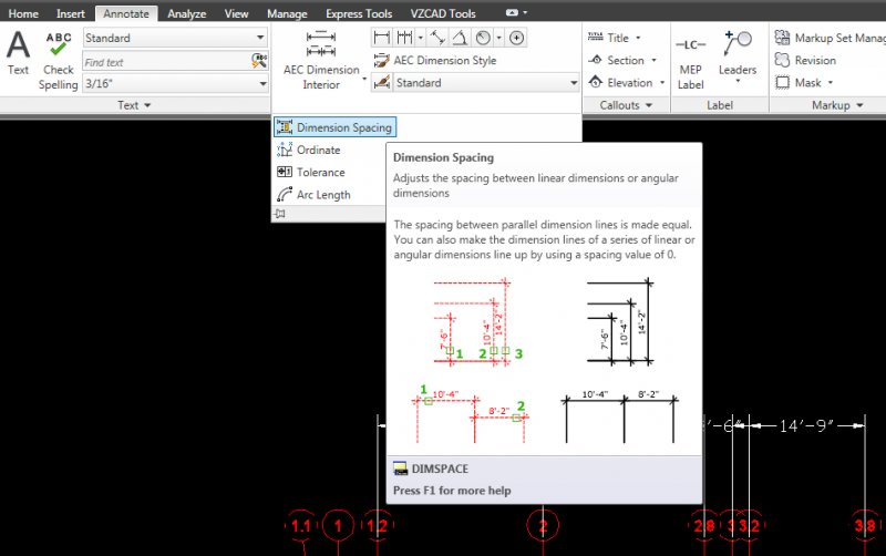

iskalipsi Posted July 21, 2010 Share Posted July 21, 2010 Hello and good evening. I received a file today of architectural plans and it seems that every time i open some of the files(all files except for the title block) i am stuck to 99% in cad reading the file and i get this msg (pls see attached file).What could possibly be wrong? I can't upload file in here because it exceeds the maximum file size. Quote Link to comment Share on other sites More sharing options...
