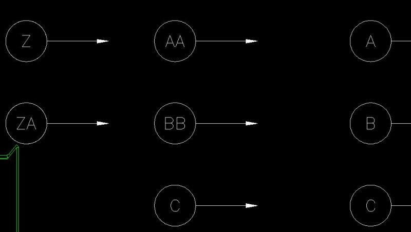

rkmcswain Posted July 26, 2010 Share Posted July 26, 2010 ....I wonder how to get the number of the thread as you did before. One way. Look in the address bar of the thread... Quote Link to comment Share on other sites More sharing options...
Tharwat Posted July 26, 2010 Share Posted July 26, 2010 One way. Look in the address bar of the thread...[ATTACH]21973[/ATTACH] Yaaa ... Thank you so much. it is appreciated. Tharwat Quote Link to comment Share on other sites More sharing options...
