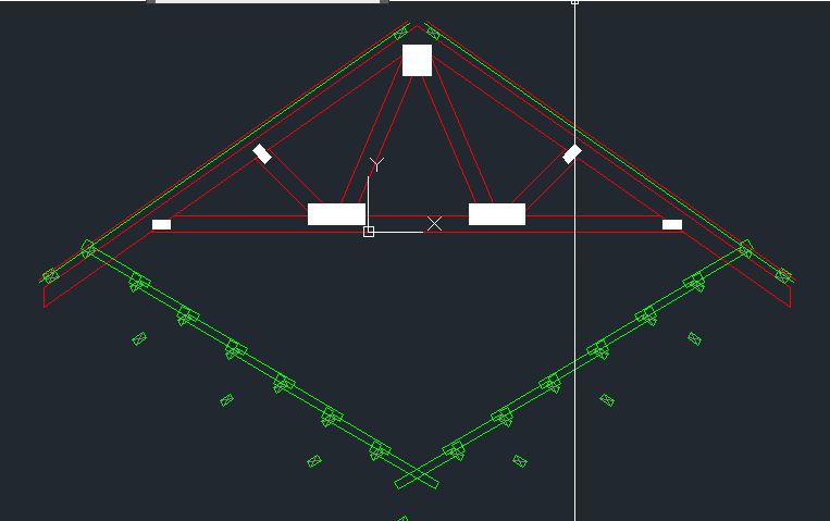

marmo Posted October 9, 2010 Share Posted October 9, 2010 A quick example of design in autocad 2d/3d: You can use "section plane" to view a live-section and generate the corresponding blocks. The blocks, that are designed only with lines and hatch, can be updated at any time. Than you can frame different views, and blocks in paper space. It 's true that unlike other software autocad has its limits... Quote Link to comment Share on other sites More sharing options...
