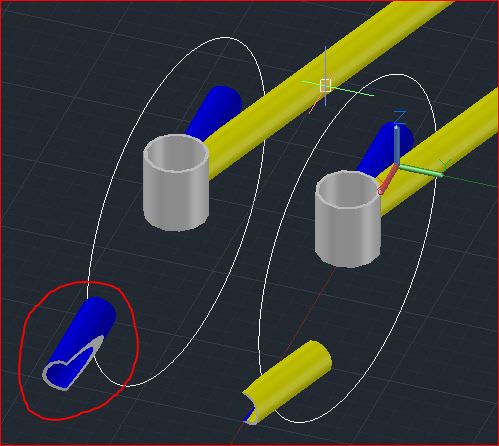

when your placing signs lets say on a piece of paper in autocad
you only want a map on 1 side/ the side thats visible,
to apply to a single faces
press and hold control key and then click and drag the material to the object without letting go of the ctrl key
at times things will get disoriented or tilted at an angle, im not sure exactly why it happens but to fix it go to the render tab, or find material mapping, switch it to box and use the ctrl key to select a face, you can then use the move and rotate gizmo to align the material back into place, if you struggle to get the gizmo at a perfect 0 or 90 degree angle you can turn on ortho mode to get perfect alignment on a 0,90,180 degree angle/ horizontal, or vertical
