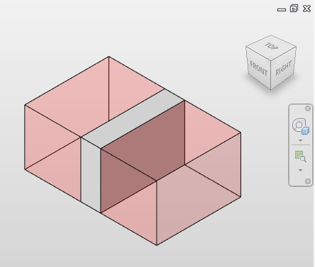

Jack_O'neill Posted January 17, 2012 Share Posted January 17, 2012 Does civil 3d have press-pull? it dont' get any easier than that. Drop in the shape, start the press-pull command, and drag it out as far as you need to: Quote Link to comment Share on other sites More sharing options...
