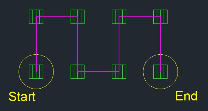

BigAl - I'm not sure I follow but that's prolly because I don't have any experience with CIV3. However I can post a picture to help clarify what I'm after....
I think I may have to wait until I'm a junior member? I don't have an option to upload.....errr wait try this: https://docs.google.com/open?id=0Bz-ld2aFpGVZMGIzNGZjY2QtNjY4Ni00NGEwLWI2MzQtMzllMGNiNDY1Mjhj
Basically these are not difficult to draw but I would like to see if I can automate the process. You can see the top and bottom grade are imput (Station, Elevation) then the top and bottom of wall are drawn based on the top and bottom grade.
Wait maybe I can attach. Sorry if this ends up really messy.
RW Example.pdf
