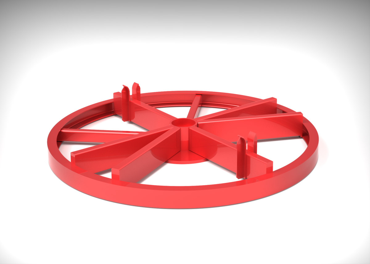

trogpot Posted September 4, 2012 Share Posted September 4, 2012 I am trying to make a cam that drives a disk at 90 degrees to the cam.When i use constrates I can get it to rotate in a continuous motion,but I only want the disk to move when it is in contact with the cam rotating.Can any one please suggest a method of doing this.Is it even posible to do this Quote Link to comment Share on other sites More sharing options...
JD Mather Posted September 4, 2012 Share Posted September 4, 2012 Yes it is possible. Attach your assembly here. Quote Link to comment Share on other sites More sharing options...
trogpot Posted September 4, 2012 Author Share Posted September 4, 2012 Thank you for replying.I am operating version 2010 of inventor.I have sentyou the basic cam arrangemnet drawing.I make automata(mech toys)so for thatreason it is very basic at this moment,as I have yet to decide the final camshape Quote Link to comment Share on other sites More sharing options...
JD Mather Posted September 5, 2012 Share Posted September 5, 2012 I do not see the files attached? All I see is an bitmap image. Do you have the Inventor Profession 2010 (you will need Environment>Dynamic Simulation) Quote Link to comment Share on other sites More sharing options...
kencaz Posted September 6, 2012 Share Posted September 6, 2012 Thank you for replying.I am operating version 2010 of inventor.I have sentyou the basic cam arrangemnet drawing.I make automata(mech toys)so for thatreason it is very basic at this moment,as I have yet to decide the final camshape [ATTACH=CONFIG]36930[/ATTACH] I don't see how that cam is suppose to drive the disk. Is it friction only? Quote Link to comment Share on other sites More sharing options...
trogpot Posted September 6, 2012 Author Share Posted September 6, 2012 yes it friction only,that is why i can not use the usual constraints Quote Link to comment Share on other sites More sharing options...
kencaz Posted September 6, 2012 Share Posted September 6, 2012 yes it friction only,that is why i can not use the usual constraints As JD stated, you would need dynamic simulation (pro version), if you don't have pro, you could use Studio and some time-line tricks to visualize it but would not prove functionality. I know contact solver would not work either. Quote Link to comment Share on other sites More sharing options...

JD Mather Posted September 7, 2012 Share Posted September 7, 2012 (edited) Not sure this friction cam will work particularly well since the contact surface feet per minute will be greater the further you move out from the wheel centerpoint. Is this a low speed application? Edited September 10, 2012 by JD Mather Quote Link to comment Share on other sites More sharing options...
trogpot Posted September 10, 2012 Author Share Posted September 10, 2012 The cam and disk ( which are wooden) is rotating at no morethan one RPM,as it is being hand cranked. Perhaps if we look at from adifferent perspective. I just need to see the movement taking place, so I can integratethis movement into the automata(mechanical toy)to operate a rotation movement,which will be part of the body of a archer that picks up and fires a arrow.Perhaps I am asking/expecting to much ofInventor. There is a movement called the "Da Vinci reciprocatingmovement" which instead of using a cam/disk, uses two lantern gears and apegged disk, to do the same kind of action Quote Link to comment Share on other sites More sharing options...
JD Mather Posted September 10, 2012 Share Posted September 10, 2012 Perhaps I am asking/expecting to much of Inventor. It is easy to do with Inventor Professional - Dynamic Simulation. I already indicated this in the first response. And from kencaz Reponse #7 If all you want to do is animate - not test kinematics, you can do this with Inventor Studio Environment with standard Inventor. Quote Link to comment Share on other sites More sharing options...
Dana W Posted September 10, 2012 Share Posted September 10, 2012 Not sure this friction cam will work particularly well since the contact surface feet per minute will be greater the further you move out from the wheel centerpoint.Is this a low speed application? Mr. Mather is probably right. Also, I don't think there is enough contact patch for the program to be able to work with. Unless Inventor can deal with the intrinsic but minute pressure and flex in your device that will allow more friction to develop, the contact area is a single mathmatical point, esentially it is equal to zero. Perhaps, Mr. Da Vinci, if he had chosen to use the cam and wheel, would have decided to wrap the cam in leather, or some other compressible material to improve the size of the contact area, and thus the friction coefficient between the two objects. He may also have used a peg or three in the center of the cam, and a series of holes in the wheel. Quote Link to comment Share on other sites More sharing options...
JD Mather Posted September 10, 2012 Share Posted September 10, 2012 I don't think there is enough contact patch for the program to be able to work with. Unless Inventor can deal with the intrinsic but minute pressure and flex .... Inventor Dynamic Simulation assumes perfect parts - no flex. It would be handled with a trick in Inventor. I will try to present solution when I get a chance, but as the OP is not using 2013..... .....more work for me, less motivation.... Quote Link to comment Share on other sites More sharing options...
