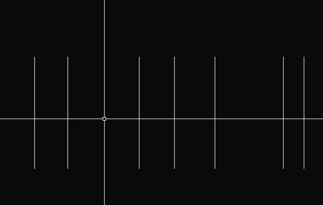

CADproNY Posted December 14, 2012 Share Posted December 14, 2012 (edited) I am trying to create a dropdown list, what I am looking to do seems simple enough in theory. Just like excel I want to create a data validation (list). option 1, I have read several post's with people who seem to be trying to accomplish the same thing, the answers I am finding are basically saying to paste a link to the excel file. This would be great except the folder the excel file would be in is always re-named from (template) to a specific job name, thus causing my link to break and teaching everyone in the dept. how to re-link the file seems like a pain. option 2, I was thinking of doing a visibility state on an mtext or attribute, I couldn't get the attribute to change visibility states and the visibility state for mtext does not seem like the right solution. option 3, using a table or data extraction in CAD from the pasted in excel file, thus allowing me to create the drop down list. Attached are 2 pictures of the what I am working with, we use an excel file to write out a list of materials (always different) and then we have to re-type or copy and paste these materials into the titleblock. We are using ACAD Arch 2012 & 2013 Thanks in advance for any advice, macros, or solutions !Problem = Need drop down list ---> Want to select the W# ---> Want the description to populate the titleblock from CAD table or excel Edited December 14, 2012 by CADproNY Quote Link to comment Share on other sites More sharing options...
