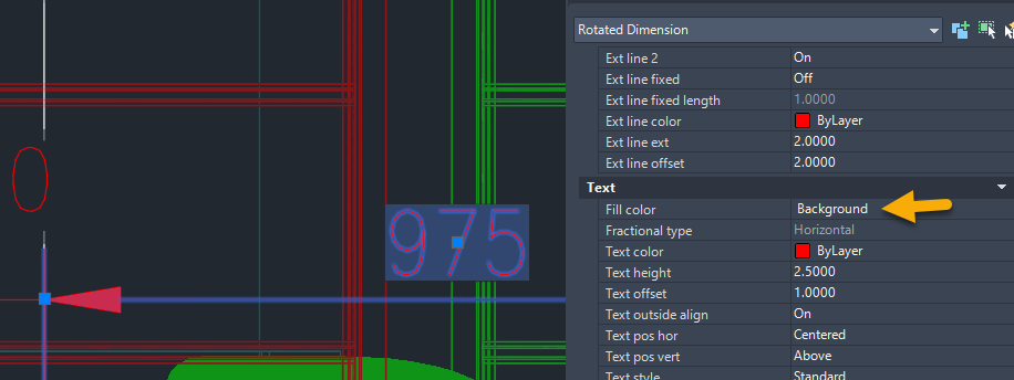

ScribbleJ Posted May 8, 2013 Share Posted May 8, 2013 Hey guys and gals. Its been quite some time since I have posted anything but I have an issue that has perplexed me and I can't figure it out and I need some help. I am using JPEG images for my current project. It has just recently started doing this. I don't recall changing anything at all that would cause this either. I normally plot to PDF's. It is actually vital that I do plot to PDF's considering I have to send them to the client for the review submittal. I can't figure out what is going on so I hope someone here has dealt with this issue before. I have looked at everything I can think of. I use Raster Design to insert my JPEG's and crop them to the areas that I need. I am not an amateur at this. I've been a drafter/designer for 24 years so I don't get stumped very much. This one has certainly stumped me. The image below is what it should look like when its plotted to PDF. (Screenshot is from the AutoCad Drawing) This is what the image looks like when it is plotted to PDF. (Screenshot is from the PDF created from the AutoCad drawing.) Quote Link to comment Share on other sites More sharing options...
ReMark Posted May 8, 2013 Share Posted May 8, 2013 What is FILLMODE set to? Quote Link to comment Share on other sites More sharing options...
ScribbleJ Posted May 8, 2013 Author Share Posted May 8, 2013 Seriously? That will affect an image? Its set to 1. This has just started all of a sudden. It started last Friday. Before that everything plotted just fine. Quote Link to comment Share on other sites More sharing options...
ScribbleJ Posted May 8, 2013 Author Share Posted May 8, 2013 Could the DWGtoPDF.pc3 file become corrupted? I just noticed that a fill pattern I used in my Index Key is not plotting either. There is a clue there. Quote Link to comment Share on other sites More sharing options...
ReMark Posted May 8, 2013 Share Posted May 8, 2013 Well to me it looked like some text and lines were not being filled in thus my question re: fillmode. Quote Link to comment Share on other sites More sharing options...
ScribbleJ Posted May 8, 2013 Author Share Posted May 8, 2013 (edited) Sure I understand why you asked about that. I just don't think it applies to an image. There is no vector data in this file except for the border and title block but its plotting fine. I exported the image from a PDF provided for us to use. I have tried more than one image file type (not that I expected it to change anything) but I am at the end of my rope on this issue. Edit: Correction. The border and titleblock are not plotting correctly either. Polyline widths are not plotting as hollow objects with an outline. Edit: Now the border and title block are plotting fine. I think its time to repair AutoCad. Or uninstalled/reinstall. Edited May 8, 2013 by ScribbleJ Quote Link to comment Share on other sites More sharing options...
