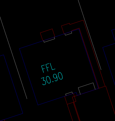

Looking for a Lisp which will allow me to centre text within a block.
Example below where I would like the text to be centered within the block with max 2 clicks. Ideally I could do this on mass as I have 300 or so to do but not sure if possible.
Thanks,
A better explanation is required. Is the text part of the Block? It would be easier to help if you provided a small sample drawing with a couple of examples.
The text is Mtext. I want to be able to click the blue line of the box and have the text centered within in.
Thanks,
What version of AutoCAD are you using? If 2017 or above, are you aware of the "gcen" (geometric center) object snap modifier? That would make it easy - no lisp required.
