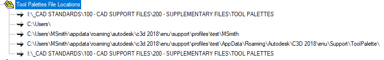

That added a bunch of things that don't need to be there (see screenshot, I think the list parameter messed it up because of the (getusername)?).    Why would I want to run the code above over this:
(setvar "*_toolpalettepath" (strcat "C:\\Users\\" (getenv"Username") "\\AppData\\Roaming\\Autodesk\\C3D 2018\\enu\\Support\\ToolPalette\\" (chr 59) "I:\\_CAD STANDARDS\\100 - CAD SUPPORT FILES\\200 - SUPPLEMENTARY FILES\\TOOL PALETTES"))
Edited by Sportyyyy
wrong pic
the code ronjonp made is just an example on how to append multiple paths to the existing one. If you run it multiple times it will append multiple times. In this case indeed you would need to check if the path was already added or not.
The last code you posted creates a new one (resets) that's made up from 2 paths only  C:\Users... + I:\_CAD... , so this you can run as much a you like. Don't know why the vla-code doesn't work for you because on my computer nos problemos??
