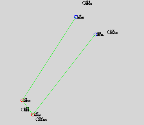

Hi ojacomarket, as far as I can see , there is no any line where you can pick to a TEXT , furthermore that are , at least  , 3 text nearby each circle.
Each text is in its layer: 3 text 3 layers.
All this layer has color bylayer to color 250 , black for me , as  I use an almost white  modelspace screen .
It will be nice , if you can upload a sample dwg with a BEFORE ,  and AFTER , so it will be clear what to be do.
Hi, thank you very much for the feedback. My text above is very long, and explanation is poor, so I apologize for that.
I pinned two dwg, what is before and after what is expected. Also I pinned my lisp which works for creation lines between circle centers with specified text nearby.
testAFTER.dwg test.dwg asap.lsp
As in your post on april 8 , dlanorh state
Quote
I think you'll find that the insertion point of the text is the same as the centre of the circle (Top Left) and each text is preceeded by a space.
 So I guess you want to make the lines as the  mootnr at  it's Layer , and to follow it's order , as you can see if the lines are by the circle ssget , it's handle are not in order m the first line was from 141 to 142 , the second from 142 to 141 , and the 3 rd fom 141 to 139
Handle number give the order how they  had be done .
19 minutes ago, devitg said:
As I can see, there is no a regular or congruent way to follow the nro at the  "mootnr"  layer
nro 55 is lost
test-beforepoint 55 is lost-s1 as nro and nro lost.dwg 645.18 kB · 0 downloads
Thank you for feedback!
As I said before, sorry for poor explanantion.
The main goal of that code is:
a) I select with mouse cursor the text, for example, "kill1"
b)"kill1" is nothing more that "kill + order nr." - it is just text, but this text SHOULD assign the linetype and layer of the future lines, that will join ALL circles nearby this "kill" text.
c) So I want AutoCAD to recognize that I have selected "kill1", then it knows that FUTURE LINES, THAT WILL JOIN EVERY CIRCLE , which have nearby text "kill + order nr." it should be at Layer "0" with Linetype "Continuous" (I mean those lines should be at "0" layer and "Continuous"  linetype, the TEXT "kill + order nr."  should stay at current layer with no changes)
Well, your code is prompting for the selection of a circle, not text, so how should it recognise the texts?
If I'm understanding right, you prefer the same texts in the same unique layer with the linetype "CONTINUOUS". If that's the case, you can simply put it in, for example, "PLTRACE-kill1" layer or something like that.
