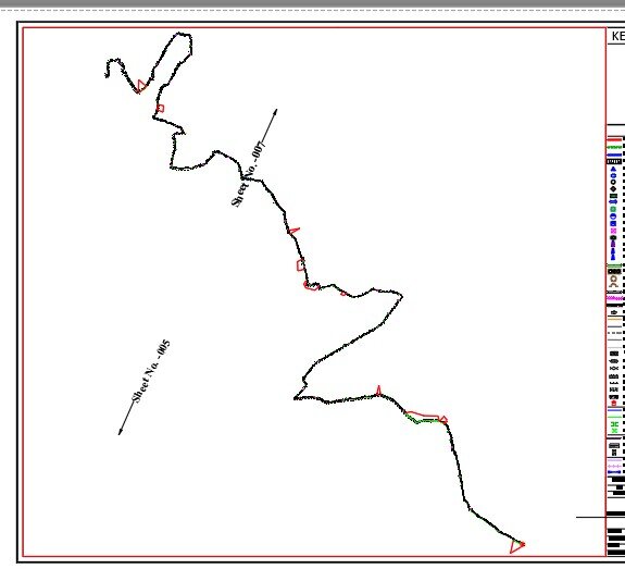

pmadhwal7 Posted July 1, 2020 Share Posted July 1, 2020 (edited) nearly 300 layouts to be prepare in my file, i just want to know is there any way to zoom and extents inside of all my viewports, Edited July 1, 2020 by pmadhwal7 Quote Link to comment Share on other sites More sharing options...
rlx Posted July 1, 2020 Share Posted July 1, 2020 maybe one of these? linky 1 linky 2 Quote Link to comment Share on other sites More sharing options...
BIGAL Posted July 1, 2020 Share Posted July 1, 2020 I think you have asked wrong question, if you just zoom e its the same as copying 1 layout 299 times. That's LAYOUT command. Do you mean walk along the pline and zoom at a scale inside a viewport making 300 layouts ? Quote Link to comment Share on other sites More sharing options...

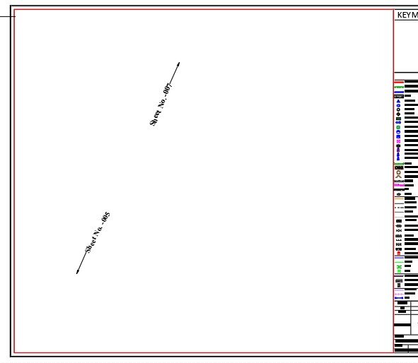

pmadhwal7 Posted July 2, 2020 Author Share Posted July 2, 2020 14 hours ago, rlx said: maybe one of these? linky 1 linky 2 both lsp are working perfect but only in one layout the same thing i want to do in all layouts. Quote Link to comment Share on other sites More sharing options...
pmadhwal7 Posted July 2, 2020 Author Share Posted July 2, 2020 5 hours ago, BIGAL said: I think you have asked wrong question, if you just zoom e its the same as copying 1 layout 299 times. That's LAYOUT command. Do you mean walk along the pline and zoom at a scale inside a viewport making 300 layouts ? actually i have 300 sheets and which i copy from another dwg and they already have viewports, lsp that rlx provided are perfectly fitting but only in one layouts Quote Link to comment Share on other sites More sharing options...
rlx Posted July 2, 2020 Share Posted July 2, 2020 (edited) in that case you need something like this (setq old-ctab (getvar "CTAB")) (foreach layout (layoutlist) (setvar "CTAB" layout) ;put call to mview zoom command here ) (setvar "CTAB" old-ctab) Edited July 2, 2020 by rlx Quote Link to comment Share on other sites More sharing options...
pmadhwal7 Posted July 2, 2020 Author Share Posted July 2, 2020 2 hours ago, rlx said: in that case you need something like this (setq old-ctab (getvar "CTAB")) (foreach layout (layoutlist) (setvar "CTAB" layout) ;put call to mview zoom command here ) (setvar "CTAB" old-ctab) please tell me where to put those code? Quote Link to comment Share on other sites More sharing options...
rlx Posted July 2, 2020 Share Posted July 2, 2020 ;;; zoome.lsp - Zoom extents in all viewports - By Jimmy Bergmark - Copyright (C) 1997-2006 JTB World, All Rights Reserved ;;; Website: www.jtbworld.com - E-mail: info@jtbworld.com - 2000-08-29 - Tested on AutoCAD 2000 (defun c:zoome (/ oldcmdecho vplist curcvport nr vpss ms en x) (setq oldcmdecho (getvar "cmdecho"))(setvar "cmdecho" 0)(setq vplist (mapcar 'car (vports)))(setq curcvport (getvar "cvport")) (if (= (getvar "tilemode") 0) (progn (if (= (setq ms (getvar "cvport")) 1)(command "._mspace")) (setq nr 0 vpss (ssget "_x" (list '(-4 . "<AND") '(0 . "VIEWPORT")(cons 410 (getvar "ctab")) '(-4 . "<NOT") '(69 . 1) '(-4 . "NOT>") '(-4 . "AND>")))) (if vpss (repeat (sslength vpss) (setq en (entget (ssname vpss nr))) (if (and (= 0 (logand 1 (cdr (assoc 90 en))))(< 0 (cdr (assoc 68 en)))(/= 16384 (logand 16384 (cdr (assoc 90 en))))) (progn (setvar "cvport" (cdr (assoc 69 en)))(command "._zoom" "_e"))) (setq nr (+ 1 nr)) ) ) (if (= ms 1) (command "._pspace")) ) (foreach x vplist (setvar "cvport" x) (command "._zoom" "_e")) ) (setq vpss nil)(setvar "cvport" curcvport)(setvar "cmdecho" oldcmdecho) (princ) ) ; zoom extents all view ports rlx 2 jul 2020 (defun c:zeavp ( / c)(setq c (getvar "CTAB"))(foreach l (layoutlist) (setvar "CTAB" l)(c:zoome))(setvar "CTAB" c)(princ)) (princ "\nType zeavp or (c:zeavp) to run") (princ) 1 Quote Link to comment Share on other sites More sharing options...
pmadhwal7 Posted July 2, 2020 Author Share Posted July 2, 2020 1 hour ago, rlx said: Great Sir it was working fine thanks a lot ;;; zoome.lsp - Zoom extents in all viewports - By Jimmy Bergmark - Copyright (C) 1997-2006 JTB World, All Rights Reserved ;;; Website: www.jtbworld.com - E-mail: info@jtbworld.com - 2000-08-29 - Tested on AutoCAD 2000 (defun c:zoome (/ oldcmdecho vplist curcvport nr vpss ms en x) (setq oldcmdecho (getvar "cmdecho"))(setvar "cmdecho" 0)(setq vplist (mapcar 'car (vports)))(setq curcvport (getvar "cvport")) (if (= (getvar "tilemode") 0) (progn (if (= (setq ms (getvar "cvport")) 1)(command "._mspace")) (setq nr 0 vpss (ssget "_x" (list '(-4 . "<AND") '(0 . "VIEWPORT")(cons 410 (getvar "ctab")) '(-4 . "<NOT") '(69 . 1) '(-4 . "NOT>") '(-4 . "AND>")))) (if vpss (repeat (sslength vpss) (setq en (entget (ssname vpss nr))) (if (and (= 0 (logand 1 (cdr (assoc 90 en))))(< 0 (cdr (assoc 68 en)))(/= 16384 (logand 16384 (cdr (assoc 90 en))))) (progn (setvar "cvport" (cdr (assoc 69 en)))(command "._zoom" "_e"))) (setq nr (+ 1 nr)) ) ) (if (= ms 1) (command "._pspace")) ) (foreach x vplist (setvar "cvport" x) (command "._zoom" "_e")) ) (setq vpss nil)(setvar "cvport" curcvport)(setvar "cmdecho" oldcmdecho) (princ) ) ; zoom extents all view ports rlx 2 jul 2020 (defun c:zeavp ( / c)(setq c (getvar "CTAB"))(foreach l (layoutlist) (setvar "CTAB" l)(c:zoome))(setvar "CTAB" c)(princ)) (princ "\nType zeavp or (c:zeavp) to run") (princ) Quote Link to comment Share on other sites More sharing options...
