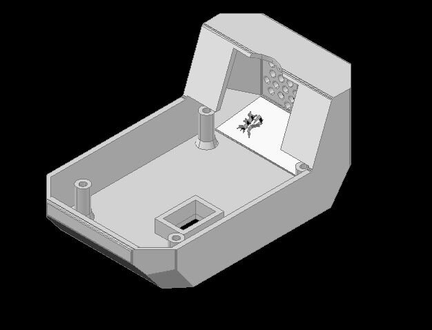

Berzerker Posted August 7, 2020 Share Posted August 7, 2020 Ok I'm having to move some holes on my cover plate for a project to be printed on a 3D printer. I have plugged the holes but they still show up in the drawing as a circle that you can see. Is this going to mess up my printing operation. I know it needs to be what they call water tight. Here it is shaded here it is not Quote Link to comment Share on other sites More sharing options...
Cad64 Posted August 7, 2020 Share Posted August 7, 2020 How did you plug the holes? If you simply inserted some solid cylinders, that's not going to work for printing. You will need to Union the cylinders to the cover plate so it's one complete solid object. Quote Link to comment Share on other sites More sharing options...
Berzerker Posted August 7, 2020 Author Share Posted August 7, 2020 I did union them and when you hover over the object it shows it as one unit but I plugged another hole and it doesn't look like that. Working on it now. Thanks I didn't think so. Quote Link to comment Share on other sites More sharing options...
Berzerker Posted August 7, 2020 Author Share Posted August 7, 2020 Found my problem. I made the hole .188 and made the plug .187 Thanks Quote Link to comment Share on other sites More sharing options...
Cad64 Posted August 7, 2020 Share Posted August 7, 2020 For future reference, an easier and faster way to fill holes would be to use the Solidedit command. Command: SOLIDEDIT Choose the FACE option Choose the DELETE option Click on the cylinder face inside the hole so that it becomes highlighted Hit Enter and then exit the command It might look like nothing happened, but once you Regen or Orbit around the model to refresh the view, you will see that the hole is gone. Quote Link to comment Share on other sites More sharing options...

Berzerker Posted August 7, 2020 Author Share Posted August 7, 2020 OK I think I've got everything right...."Not real sure". I want to load it into cura and see if it will accept it as a solid. But I don't see it listed in the files. I'm guessing it has to do with it being in a drawing file. How do you save it for 3D printing? Do I need to get rid of everything else in the drawing? Does it need to be from a certain view, "Top, Right, Bottom". I don't have the printer a friend of mine does and he's going to do it for me. I just want to make sure I have all my ducks in a row before I send it to him. Quote Link to comment Share on other sites More sharing options...
Cad64 Posted August 7, 2020 Share Posted August 7, 2020 The view doesn't matter, but the model does need to be in the positive X,Y,Z space. You don't need to delete everything else in the drawing. When you export the model, you will be able to select what you want to export. For the file format, export it to .stl format. Quote Link to comment Share on other sites More sharing options...
Berzerker Posted August 7, 2020 Author Share Posted August 7, 2020 (edited) Does it need to be shaded or not. Why does it look so small? It's drawn to scale. Edited August 7, 2020 by Berzerker Quote Link to comment Share on other sites More sharing options...
Cad64 Posted August 7, 2020 Share Posted August 7, 2020 8 minutes ago, Berzerker said: Does it need to be shaded or not When you export to .stl format, you're only exporting the information that defines the model. Things like texture maps, lighting, shading, etc. don't matter. That's just for viewing inside Autocad. Quote Link to comment Share on other sites More sharing options...
Berzerker Posted August 7, 2020 Author Share Posted August 7, 2020 OK but it looks real small. I had to zoom in just to find it. Quote Link to comment Share on other sites More sharing options...
Cad64 Posted August 7, 2020 Share Posted August 7, 2020 2 minutes ago, Berzerker said: OK but it looks real small. I had to zoom in just to find it. In Autocad, where is your model located? Is it at X0,Y0? If it's not at the origin, that might be why you need to zoom in. Go back to Autocad and move your model if necessary so that it's sitting at the XYZ origin and then export again. Quote Link to comment Share on other sites More sharing options...

Berzerker Posted August 7, 2020 Author Share Posted August 7, 2020 (edited) Thanks Cad64 I just figured it out. Just incase someone else reads this when you load it into cura it comes up with the dimensions in mm. Meaning that if you draw it at 4" when you insert it into cura/3D printer program 4" becomes 4mm. I found the scale button and times the 4mm X 25.4. entered that value in the first slot and it changed the rest. Edited August 7, 2020 by Berzerker Quote Link to comment Share on other sites More sharing options...
Cad64 Posted August 8, 2020 Share Posted August 8, 2020 Looks good, now you just need to print it. Although, you might run into problems with that overhang. I think it would be better to print this as separate pieces and then glue them together. Quote Link to comment Share on other sites More sharing options...
