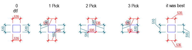

    Toggle dimension LISP
    I've tested the code. In this way, it is difficult to guess the desired position of the dimensional text. Then you have to manually correct the position of the dimensional text.

  6. ScottMC
    (defun c:dtf (/ *error* ent obj entg dimsc but counter) (princ "\n Move DIM Text to Various Points..") ;; https://www.cadtutor.net/forum/topic/97280-toggle-dimension-lisp/#findComment-666274 (defun *error* ( msg ) (setvar 'cmdecho 0) ;; 5.28.24 (vla-endundomark (vla-get-activedocument (vlax-get-acad-object))) (if msg (prompt (strcat "\n" msg))) (setvar 'cmdecho 1) (princ) ) (defun dotx (/) (princ "\n ** Reset **..") (command "dimoverride" "c" ent "") (command "dim1" "hometext" ent "") ) (defun dotl (/) (setq tpos (mapcar '+ (cdr (assoc 13 entg)) (list 0 dimsc 0.0))) ;; (vlax-put obj 'TextMovement 1) (vlax-put obj 'TextPosition tpos) ) (defun dotr (/) (setq tpos (mapcar '+ (cdr (assoc 14 entg)) (list 0.5 dimsc 0.0))) (vlax-put obj 'TextMovement 1) (vlax-put obj 'TextPosition tpos) ) (defun dobl (/) (setq tpos (mapcar '+ (cdr (assoc 13 entg)) (list 0.0 (- dimsc) 0.0))) (vlax-put obj 'TextMovement 1) (vlax-put obj 'TextPosition tpos) ) (defun dobr (/) (setq tpos (mapcar '+ (cdr (assoc 14 entg)) (list 0.0 (- dimsc) 0.0))) (vlax-put obj 'TextMovement 1) (vlax-put obj 'TextPosition tpos) ) (setvar 'cmdecho 0) (setq counter 2) (while (setq ent (car (entsel "\n Pick DIM: "))) (setq entg (entget ent)) (setq obj (vlax-ename->vla-object ent)) (setq dimsc (vlax-get obj 'scalefactor)) (if (= but nil) (setq but 1)) (cond ((= counter 1) (dotl)) ((= counter 2) (dotr)) ((= counter 3) (dobl)) ((= counter 4) (dobr)) ((= counter 5) (dotx)) ) (setq counter (+ counter 1)) (if (= counter 6) (setq counter 1)) ) (setvar 'cmdecho 1) (*error* nil) (princ) )

  13. jrr114
    Scott, This works with one problem. I hope you can fix it. The leader line becomes to long when selecting the dimension to relocate. If it could stayat the original length, this would be awesome. Thank you for your efforts.

  25. BIGAL
    Something is missing here, in my code it was the call to the Radio button DCL (if (= but nil) (setq but 1)) (cond ((= counter 1) (dotl)) ....... You only set counter to 2 ? You could do a "enter number 1-5 or press enter" Enter will add 1 to counter value. Need to wrap in a while to do this.

  27. ScottMC
    (defun c:dodimcorner-while (/ *error* ent obj entg dimsc but counter) (defun *error* ( msg ) (setvar 'cmdecho 0) ;; 5.28.24 (vla-endundomark (vla-get-activedocument (vlax-get-acad-object))) (if msg (prompt (strcat "\n" msg))) (setvar 'cmdecho 1) (princ) ) (defun dotl (/) (setq tpos (mapcar '+ (cdr (assoc 13 entg)) (list 0 dimsc 0.0))) (vlax-put obj 'TextMovement 1) (vlax-put obj 'TextPosition tpos) ) (defun dotr (/) (setq tpos (mapcar '+ (cdr (assoc 14 entg)) (list 0.5 dimsc 0.0))) (vlax-put obj 'TextMovement 1) (vlax-put obj 'TextPosition tpos) ) (defun dobl (/) (setq tpos (mapcar '+ (cdr (assoc 13 entg)) (list 0.0 (- dimsc) 0.0))) (vlax-put obj 'TextMovement 1) (vlax-put obj 'TextPosition tpos) ) (defun dobr (/) (setq tpos (mapcar '+ (cdr (assoc 14 entg)) (list 0.0 (- dimsc) 0.0))) (vlax-put obj 'TextMovement 1) (vlax-put obj 'TextPosition tpos) ) (setvar 'cmdecho 0) (setq counter 2) (while (setq ent (car (entsel "\nPick a dim "))) (setq entg (entget ent)) (setq obj (vlax-ename->vla-object ent)) (setq dimsc (vlax-get obj 'scalefactor)) (if (= but nil) (setq but 1)) (cond ((= counter 1) (dotl)) ((= counter 2) (dotr)) ((= counter 3) (dobl)) ((= counter 4) (dobr)) ) (setq counter (+ counter 1)) (if (= counter 5) (setq counter 1)) ) (setvar 'cmdecho 1) (*error* nil) (princ) ) ;;; UPDATE TO INCLUDE RESET ;; (defun c:dtf (/ *error* ent obj entg dimsc but counter) (princ "\n Move DIM Text to Another Location..") ;; https://www.cadtutor.net/forum/topic/97280-toggle-dimension-lisp/#findComment-666274 (defun *error* ( msg ) (setvar 'cmdecho 0) ;; 5.28.24 (vla-endundomark (vla-get-activedocument (vlax-get-acad-object))) (if msg (prompt (strcat "\n" msg))) (setvar 'cmdecho 1) (princ) ) (defun dotx (/) (princ "\n ** Reset **..") (command "dim" "hometext" "_L" "") (command) (command) ;; resets 'dim ) (defun dotl (/) (setq tpos (mapcar '+ (cdr (assoc 13 entg)) (list 0 dimsc 0.0))) (vlax-put obj 'TextMovement 1) (vlax-put obj 'TextPosition tpos) ) (defun dotr (/) (setq tpos (mapcar '+ (cdr (assoc 14 entg)) (list 0.5 dimsc 0.0))) (vlax-put obj 'TextMovement 1) (vlax-put obj 'TextPosition tpos) ) (defun dobl (/) (setq tpos (mapcar '+ (cdr (assoc 13 entg)) (list 0.0 (- dimsc) 0.0))) (vlax-put obj 'TextMovement 1) (vlax-put obj 'TextPosition tpos) ) (defun dobr (/) (setq tpos (mapcar '+ (cdr (assoc 14 entg)) (list 0.0 (- dimsc) 0.0))) (vlax-put obj 'TextMovement 1) (vlax-put obj 'TextPosition tpos) ) (setvar 'cmdecho 0) (setq counter 2) (while (setq ent (car (entsel "\n Pick DIM: "))) (setq entg (entget ent)) (setq obj (vlax-ename->vla-object ent)) (setq dimsc (vlax-get obj 'scalefactor)) (if (= but nil) (setq but 1)) (cond ((= counter 1) (dotl)) ((= counter 2) (dotr)) ((= counter 3) (dobl)) ((= counter 4) (dobr)) ((= counter 5) (dotx)) ) (setq counter (+ counter 1)) (if (= counter 6) (setq counter 1)) ) (setvar 'cmdecho 1) (*error* nil) (princ) ) try this.. update
