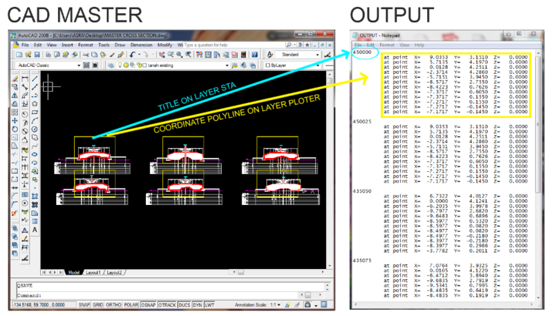

asra posted a topic in AutoLISP, Visual LISP & DCL
Hello is it possible to make lisp to extract coordinates from several polyline lines and their titles in the form of a .txt file? I have an example of the attachment below, I hope someone can help me, thank you. OUTPUT.txt MASTER CROSS SECTION.dwg -
