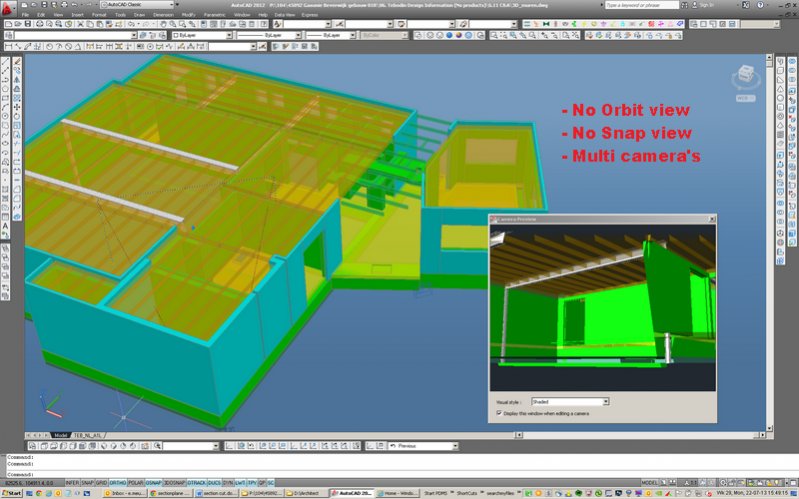

ErwinMeulman posted a topic in AutoCAD 3D Modelling & Rendering
Can somebody tell me what the best options is for a section in AutoCAD. I toggle with xref, layers on/off (edit xref in please) to get a clear work area. But mostly all xref and layers must be switch on to snap/model parts. So I look for some options: Camera options (not what I expect, I can work in this view, multi-camera's is good) Livesection (only possible for solids and not for meshes, it's slowing down you system) 3Dclip (you can't same multiple sections, it's not what I expect) So can somebody tell me what to use, maybe something like sketchup) -
