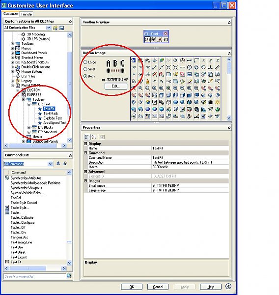

Be sure the icons for the toolbars are Acad's support path (usually in the Express folder) If that isn't the problem, open the CUI, expand Partial CUI files > Express > Toolbars > ET: Text; select a command (In this case I picked 'Text Fit'). In the right pane there will be an area 'Button Image' with the image (yours will probably be a ?) with the image name. Click Edit, Open and navigate to the button image (probably in the Express folder), click Close and that should fix it.
