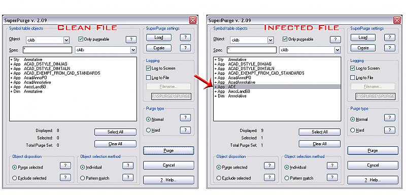

lordjkpff Posted July 8, 2009 Share Posted July 8, 2009 Unfortunately it has nothing to do with the computer station, it has to do with the dwg files. We have found the acad.vlx all over our server, it is saved where your infected drawing is saved. We used Superpurge to see if we could track down the APP. We open a CLEAN file and ran superpurge. We made a screen shot of the items it found in the drawing, it was a small list. Then we recovered a infected file and saved it. Then went back to the clean file and saved it which infected it. We confirmed by trying to open the file and it gave the language pack error. We then ran Superpurge on the file and notice ONE MORE APP had been added to the file. The APP is called: App IDs: [1] ADE THE PROBLEM IS, YOU CAN SUPERPURGE THE APP, BUT YOU CANNOT SAVE WITHOUT INFECTING THE FILE AGAIN!!! WE NEED A WAY TO PURGE THIS APP AND SAVE THE DRAWING!!! Screen Shots Before & After: Quote Link to comment Share on other sites More sharing options...
lordjkpff Posted July 8, 2009 Share Posted July 8, 2009 Just to add, i wasn't ignoring the brand new computer option, it was a great suggestion and we did that too. We are actually using the menus from that computer to replace corrupted ones on the workstations. We have narrowed the root of the problem to be contained in the dwg's. We are also trying and old school approach and creating a dummy, blank acad.vlx file and a script to replace them on our server until Autodesk tells us how to purge the app and save without re-infecting it. Quote Link to comment Share on other sites More sharing options...

lordjkpff Posted July 13, 2009 Share Posted July 13, 2009 UPDATE: Autodesk has given up on the tech support end and states that WBLOCK is the answer. Symantec has reported that they are starting to see a surge of similar requests for assistance. For basic AutoCAD files the use of WBLOCK or a "Hard" Superpurge will remove the malicious virus within the DWG. HOWEVER as for Civil 3D or any other vertical product, as of yet, there is no safe way to remove the virus without losing the intelligent data produced by the vertical product. Quote Link to comment Share on other sites More sharing options...
