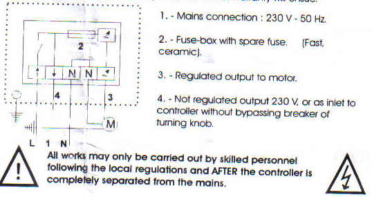

ReMark Posted July 14, 2009 Share Posted July 14, 2009 Sorry but the diagram is so small I'm having trouble reading it. Let's step back and review. You have a fan unit. How many wires are attached to it and what color are they? You have a controller of some kind. How many wires are attached to it and what color are they? Is there any other device (like a capacitor) that is present? If so, how many wires does it have and what color are they? In the U.K., in a normal wire for a house circuit, there are three wires right? The "hot" (black), the "neutral" (white) and a bare copper "ground" wire. Right? Quote Link to comment Share on other sites More sharing options...

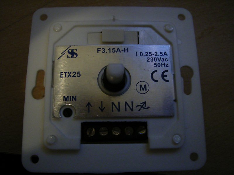

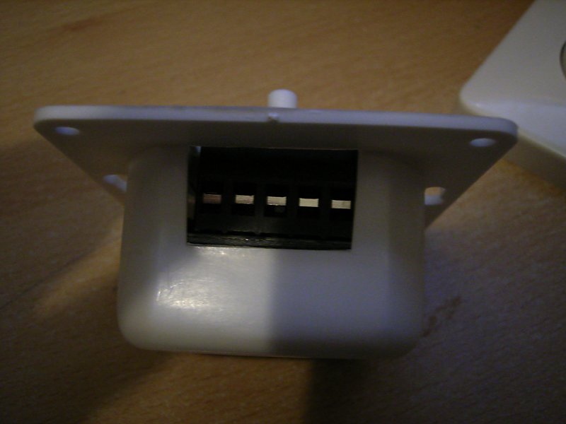

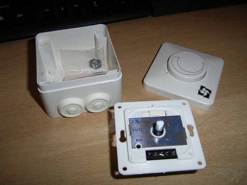

cad_student Posted July 14, 2009 Author Share Posted July 14, 2009 Sorry but the diagram is so small I'm having trouble reading it. Let's step back and review. You have a fan unit. How many wires are attached to it and what color are they? You have a controller of some kind. How many wires are attached to it and what color are they? Is there any other device (like a capacitor) that is present? If so, how many wires does it have and what color are they? In the U.K., in a normal wire for a house circuit, there are three wires right? The "hot" (black), the "neutral" (white) and a bare copper "ground" wire. Right? O.k here goes this is a closeup of the wiring diagram below,I have included a few snapshot's of the unit itself (sorry about pic quality). The wire was once complete and ran from the fan to the plug,That was until i cut the wire in half so as to connect to speed controller,The wire colours are as follows Blue-neutral,Green/Yellow-earth,Brown-live.Also i do not have a capacitor and the controller is just the unit,I connect the cut wire to it. No prob's about the disclaimer any advice is taken at my own peril:D. Quote Link to comment Share on other sites More sharing options...

CADMASTER1128 Posted July 14, 2009 Share Posted July 14, 2009 Those picture are great. Did you find them online or do you have the device? Quote Link to comment Share on other sites More sharing options...
cad_student Posted July 14, 2009 Author Share Posted July 14, 2009 Those picture are great. Did you find them online or do you have the device? I took the pictures myself,And am currently (no pun intended) in possesion of said device.Any input is most graciously appreciated. Quote Link to comment Share on other sites More sharing options...
Glen Smith Posted July 14, 2009 Share Posted July 14, 2009 Just to make sure that both aides of the pond are speaking the same language. Over here, to get 240v, we use two hots (line, live) at 120vac (Line to Neutral) each - for a difference between them of 240vac. From a quick google search, it looks like you in the EU use one hot at 240 vac line to neutral. Assuming that - disclaimer, yada yada yada... It looks like your nuetral from the supply panel should go to one of the N terminals, the Nuetral for your fan motor should go to the other (I'd use the right one for the motor) the Hot for the motor will be the terminal with your mystery symbol. The hot from the supply panel can go to either of the connections with the arrows. The left one has a breaker inside the controller box before it goes to the controller. The terminal with the arrow on the right can either bypass the breaker and supply the controller, or can be used as a breakered hot for some other device (say a light next to the fan). Let the collective knowledge of the boards look this over and comment before you take my word for it. I know nothing about UK or German electric systems. Good Luck. Glen PS, be sure to connect the grounds to the appropriate locations. Hopefully they are all marked well. Quote Link to comment Share on other sites More sharing options...

Car5858 Posted July 14, 2009 Share Posted July 14, 2009 5 Connections Up arrow = power in (L1) Down arrow= power to light N= netural in (L2) N= netural to fan Variable AC motor controler symbol = power to fan unit. Same as what Glen has explained, note that L1 and L2 are the two power legs. Disclamer applies. Quote Link to comment Share on other sites More sharing options...
