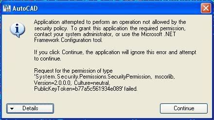

So I think this could help me greatly, we are moving some 'basemaps' and they are xrefed to many drawings, so with this we should be able to find all the drawings and remap the xref. I tryed using it and got this error. My IT guy is out right now so i couldn't check with him on it. Any idea what is wrong? I'm gussing it's on my end since others have it working.
I think this may be when the app attempts to create the log file.
Please check the details and post them.
Unfortunately I don't think there is much I can do my end, sorry. Will just have to wait until your IT bod arrives, and hope he can sort it.
Oh yeah sorry yeah that would probably help, here is what the deatils where, yeah i figure i'll probably have to wait for him to come in thanks.
See the end of this message for details on invoking
just-in-time (JIT) debugging instead of this dialog box.
************** Exception Text **************
System.Security.SecurityException: Request for the permission of type 'System.Security.Permissions.SecurityPermission, mscorlib, Version=2.0.0.0, Culture=neutral, PublicKeyToken=b77a5c561934e089' failed.
at System.Security.CodeAccessSecurityEngine.Check(Object demand, StackCrawlMark& stackMark, Boolean isPermSet)
at System.Security.CodeAccessPermission.Demand()
at System.Drawing.Icon.FromHandle(IntPtr handle)
at Autodesk.AutoCAD.ApplicationServices.Application.ShowModelessDialog(IWin32Window owner, Form formToShow, Boolean persistSizeAndPosition)
at Autodesk.AutoCAD.ApplicationServices.Application.ShowModelessDialog(Form formToShow)
at AutoArch.vbstudentClass.Xin()
at Autodesk.AutoCAD.Runtime.CommandClass.InvokeWorker(MethodInfo mi, Object commandObject, Boolean bLispFunction)
at Autodesk.AutoCAD.Runtime.CommandClass.InvokeWorkerWithExceptionFilter(MethodInfo mi, Object commandObject, Boolean bLispFunction)
at Autodesk.AutoCAD.Runtime.PerDocumentCommandClass.Invoke(MethodInfo mi, Boolean bLispFunction)
at Autodesk.AutoCAD.Runtime.CommandClass.CommandThunk.Invoke()
The action that failed was:
Demand
The type of the first permission that failed was:
The first permission that failed was:
version="1"
Flags="UnmanagedCode"/>
The demand was for:
version="1"
The granted set of the failing assembly was:
version="1">
version="1"
Read="USERNAME"/>
version="1"
Unrestricted="true"/>
version="1"
Read="H:\xin\"
PathDiscovery="H:\xin\"/>
version="1"
Allowed="AssemblyIsolationByUser"
UserQuota="9223372036854775807"
Expiry="9223372036854775807"
Permanent="True"/>
version="1"
Flags="ReflectionEmit"/>
version="1"
Flags="Assertion, Execution, BindingRedirects"/>
version="1"
version="1"
Url="
