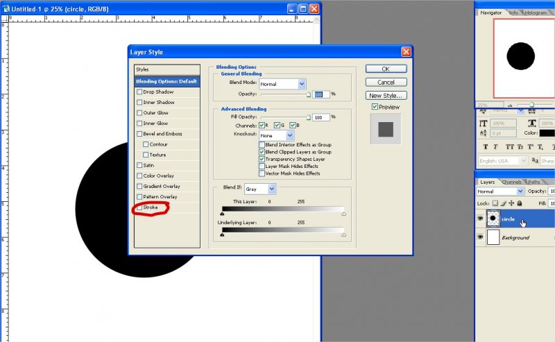

bbankston Posted November 24, 2010 Share Posted November 24, 2010 Adding strokes is really easy if you use the layer styles dialog box. Double click on your layer and you'll see a wide variety of things to choose from. See screenshots: Quote Link to comment Share on other sites More sharing options...
Lee Mac Posted November 24, 2010 Author Share Posted November 24, 2010 Sorry I haven't checked back to this thread in a while, so I've only just seen these two replies Lee if you want to be able to pan with the edge of the image in the middle of the screen then go to View>Screen Mode>Full Screen Mode with Menu Bars. That way you can do exactly what you want. Finally! That panning problem has been annoying me for ages - your full screen idea makes things much easier. Thanks for that! Adding strokes is really easy if you use the layer styles dialog box. Double click on your layer and you'll see a wide variety of things to choose from. Thanks BBankston - I usually go to Edit >> Stroke, but thanks for demonstrating another way to approach it Quote Link to comment Share on other sites More sharing options...
