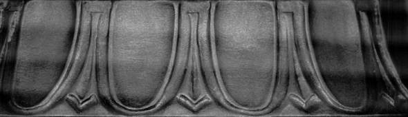

vweavers Posted September 11, 2009 Author Share Posted September 11, 2009 A combination is what I am looking for- the positive 3D of the 'slice' cylinder, along with the wrapping around the curvature of the other 2. Attached is a scan of the first wheel I am attempting. Quote Link to comment Share on other sites More sharing options...

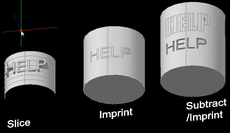

Bobzy20 Posted July 9, 2010 Share Posted July 9, 2010 Hi kencaz, can you explain how I would get my text to sit on the front face of my cylinder and cut into the surface? Thanks Bobzy20 Quote Link to comment Share on other sites More sharing options...
Bobzy20 Posted July 9, 2010 Share Posted July 9, 2010 I just Extruded the text through the object and then used the Imprint command but I seem to have those crazy white lines everywhere. Is this a side effect or can they be avoided? Bobzy20 Quote Link to comment Share on other sites More sharing options...
JD Mather Posted July 9, 2010 Share Posted July 9, 2010 I just Extruded the text .... That doesn't wrap the text. Autodesk Inventor will wrap around the cylinder. Students can download Inventor for free from http://www.autodesk.com/edcommunity Crazy white lines? dispsilh? Quote Link to comment Share on other sites More sharing options...
kencaz Posted July 9, 2010 Share Posted July 9, 2010 Hi kencaz, can you explain how I would get my text to sit on the front face of my cylinder and cut into the surface? Here is a better method: http://www.cadtutor.net/forum/showthread.php?t=49055&highlight=extrude+text KC Quote Link to comment Share on other sites More sharing options...
