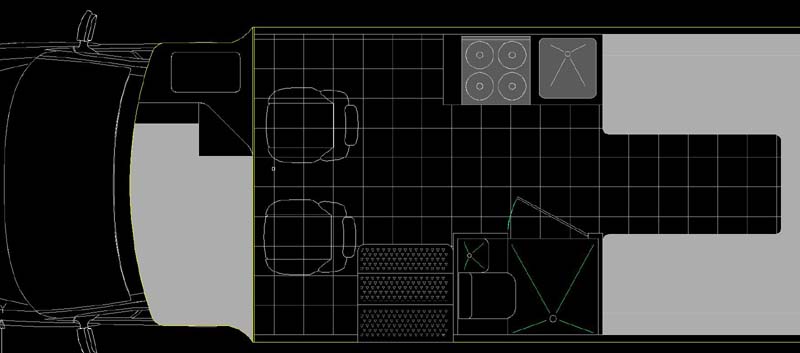

Can someone pleae tell me why the block i created of the car seat sits below the hatch pattern on the floor? I've tried selecting the seat then right-clicking on it and choosing "Draw Order" - "Bring to Front" but it does nothing.
Any ideas?
Thanks heaps
Lox
Are your car seats just outlines? You will have to Hatch the car seats too to 'fill in' the area.
I have found that occasionally I can't bring an object to the front, but can send the other object to the back. In 2010 there is also a "bring to front of other object" command. On the DRAWORDER toolbar it is called "bring above objects" and "send under objects". See if any of these will work.
