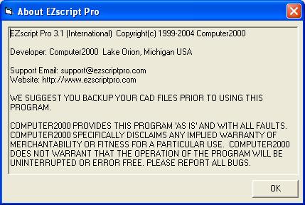

AQucsaiJr Posted October 7, 2009 Posted October 7, 2009 I have been using EZ Script Pro for about a year now and never had a problem. Runs both scripts and LISP files. I run it about twice a month on folders full of drawings that contain 200+ drawings each. Quote
rustym Posted October 7, 2009 Author Posted October 7, 2009 I have been using EZ Script Pro for about a year now and never had a problem. Runs both scripts and LISP files. I run it about twice a month on folders full of drawings that contain 200+ drawings each. I've been to that website before. I don't see any program there. It's giving me some sort of a search site?? Or I'm being stupid here? What is the link to the download page? ::EDIT:: Never mind, found it through Google at http://www.angelfire.com/clone/ezscript/ version 3.1 Thanx for sharing (will share my thoughts later) ::EDIT:: my thoughts about EZ Script Pro: More options than Scripter and works pretty well. Quote
Tiger Posted October 8, 2009 Posted October 8, 2009 I have been using EZ Script Pro for about a year now and never had a problem. Runs both scripts and LISP files. I run it about twice a month on folders full of drawings that contain 200+ drawings each. AQ - that link you posted doesn't seem to go to where you intended - mind checking it and posting the correct one? Quote
AQucsaiJr Posted October 8, 2009 Posted October 8, 2009 AQ - that link you posted doesn't seem to go to where you intended - mind checking it and posting the correct one? I don't have anouther link to the product... I pulled that link directly from the about product page. That is the link I went to about a year ago to get the product. I don't want to post a link I am unsure about so I can't update it, however I can show you the about product page and you can judge. Quote
