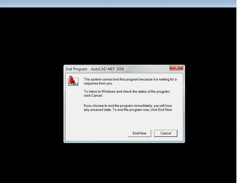

I can lock up MEP consistantly by.....
trying to impliment the 'Detail component manager' When I go to kill the program using the task manager I get the following message
anyone know what I should be doing? It acts like there is a window open but I can't find anything...escape does nothing :x

Actually I doubled my ram from 4g to 8g and I'm good to go now.
go to your task manager (left click in the task bar) and look at your "physical memory" compared to your amount of RAM... tells a story in a hurry. Turns out I (now) run constantly at 4.95G and to think I only had 4G installed. talk about a no-brainer....
