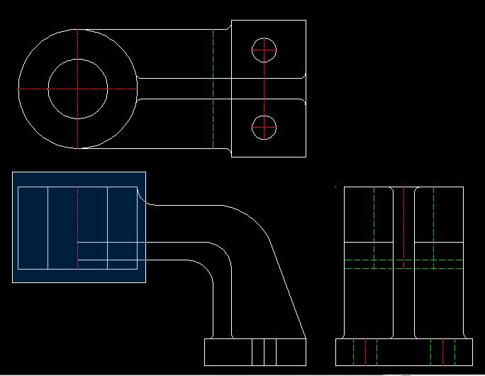

cute eng Posted November 20, 2009 Author Share Posted November 20, 2009 i make a red label how can i make these ?? it is hatched or not ?? how can i make run out ?? Quote Link to comment Share on other sites More sharing options...
JD Mather Posted November 20, 2009 Share Posted November 20, 2009 Have you covered rules for hatching ribs in section? Have you covered techniques for creating and trimming lines and arcs? Quote Link to comment Share on other sites More sharing options...
cute eng Posted November 20, 2009 Author Share Posted November 20, 2009 i make it like this see the attach. and tell me if im right or not ?? if not what is my wrong ? hw666.dwg Quote Link to comment Share on other sites More sharing options...
JD Mather Posted November 20, 2009 Share Posted November 20, 2009 In front view the rib going down center of part should not be hatched. The bottom of the cylinder is wrong size. Right side view has extraneous line. Top view has a tiny extraneous piece of garbage left over. One of the holes won't dimension position correctly as you still haven't fixed lower right corner. I would expect a student to completely finish this in about an hour, including fully dimensioned with correct line weights for object lines, center lines, hidden lines, hatch and dimensions. Quote Link to comment Share on other sites More sharing options...
cute eng Posted November 20, 2009 Author Share Posted November 20, 2009 can u make label on my mistake ?? Quote Link to comment Share on other sites More sharing options...

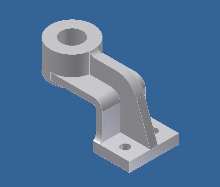

shift1313 Posted November 20, 2009 Share Posted November 20, 2009 here's my final rendering of CUTE ENG's assignment : Bearing housing made in Solidworks One other problem lulu. The main body that goes up to the bearing housing is only 80mm wide like the cylinder, not 92 like the base. Edit, i just noticed your last render was changed:) Jd, looking at the drawing i made an educated guess that the structural rib was 6mm below the top of the bearing housing and horizontal out to meet the 70degree line, at which point they have a 42mm radius fillet. Just as you said there is some info missing. To the original poster. Im amazed that i read through all of this and actually took the time to respond. Im not sure where you are located or if there may be a language barrier(though your HW is in english) but your responses in some of your replies are not nice at all. We dont get paid to help out, we give our free time/energy to help those asking. Several people told you the height of this piece was 120 yet you repeatedly stated it was not, listen to you, look again and so on. If you ask for help, accept the help you get. If you disagree, then dont use the help you get, plain and simple. Oh and the height is 120, dont tell me im wrong:D Quote Link to comment Share on other sites More sharing options...

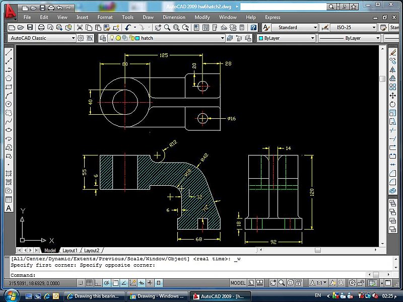

cute eng Posted November 20, 2009 Author Share Posted November 20, 2009 hwhatch.dwg can any body tell me where can i put the hatch my drawing in the attach. Quote Link to comment Share on other sites More sharing options...
JD Mather Posted November 20, 2009 Share Posted November 20, 2009 [ATTACH]15759[/ATTACH] can any body tell me where can i put the hatch my drawing in the attach. What textbook reference are you using? Does your school have a building called the library that might have many basic drafting reference books? I use Gieske et al Technical Drafting. If you tell me what book you have access to I probably have it in my library and can refer to the page you need to reference for correct section of ribs. Quote Link to comment Share on other sites More sharing options...
JD Mather Posted November 20, 2009 Share Posted November 20, 2009 [ATTACH]15759[/ATTACH] can any body tell me where can i put the hatch my drawing in the attach. You still didn't fix the lower right corner of the top view? Trim the horizonal L shape feature at the cylinder for section view. Quote Link to comment Share on other sites More sharing options...
cute eng Posted November 20, 2009 Author Share Posted November 20, 2009 You still didn't fix the lower right corner of the top view? Trim the horizonal L shape feature at the cylinder for section view. we didnt use text book i didnt understand what part you talk about exactly can you explain it in picture or in the programme thank u Quote Link to comment Share on other sites More sharing options...

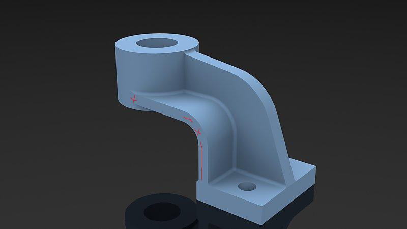

SEANT Posted November 21, 2009 Share Posted November 21, 2009 As already pointed out, the dimensions on that assignment drawing are a bit ambiguous. Is it possible that this was the intended span (see image); granted, if this were the case then the author of that drawing used poor drafting technique. But even if the intention was to dimension hole center to hole center, that technique is pretty poor. The overall proportions to of this model do seem to match that of the initial drawing pretty well. Quote Link to comment Share on other sites More sharing options...
