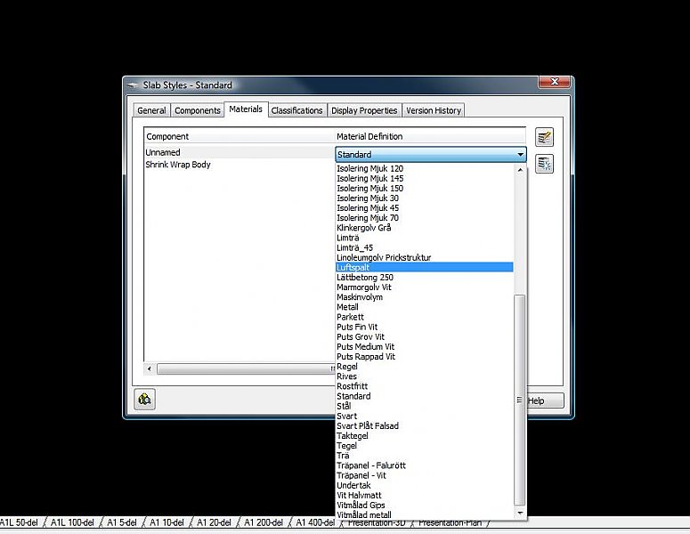

Select your slab and right click, select "Edit slab style" then choose Materials. Under Material Definition, choose your material. If there is no materials you can create your own material. How to do that?, search this forum, i´m sure it´s here:)
//Tobias
