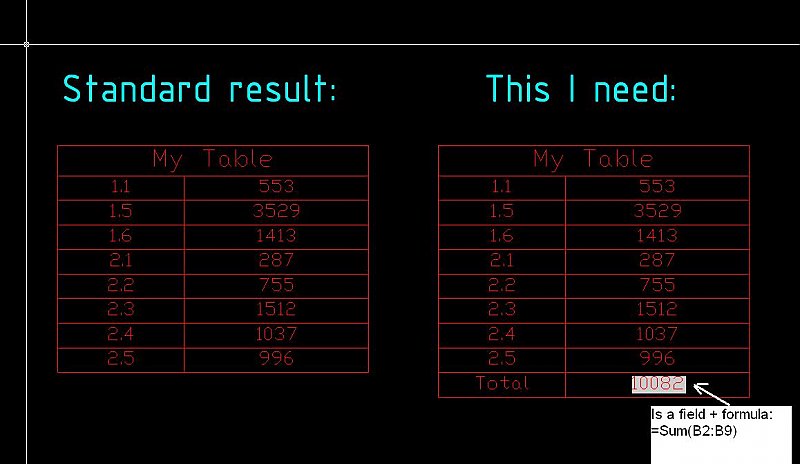

Hello everybody,
I am kind of new with tables and have some questions for those who have been there. Can somebody help me out?
Goal:
My goal is to make a routine that extracts block data (._dataextraction) based on a previous extraction.
This is saved in a template, somewhere on the server of our company.
So with "one click" (or macro / command) I need a table to "appear".
This is not the problem for it is working.
Routine so far:
(defun c:ett (/ Location ScFactor TemplatePath)
 (setq TemplatePath (strcat "C:/test.dxe")
ScFactor (getvar "dimscale")
Location (getpoint "Where? ")
 (vl-cmdf "-dataextraction" TemplatePath Location)
(vl-cmdf "_.scale" "L" "" Location ScFactor)
(prompt "\n\t\t>>>\t Type ett to start Extraction to Table \t<<<")
(prin1)
Problem:
I want this table to have an extra row below all other rows.
One of the collumns should have a formula in there: SUM the above ie. "=Sum(D3:10)".
And if possible I would like the text "total" in the collumn before it.
See the example.
How to:
Is this the way to approach it?
First define the function that creates the table, with extracted data.
Then (somehow - I do not know) add a row to last (._L) entity?
I do not know where to begin. Any help is much appreciated!
Regards,
Marco
Thank you Lee, I will look into that!
Edit: there is nothing in the Autolisp Reference and also none in the Help function in the Visual Lisp Editor...
All I can find is insertrows and insertrowsandinherit but that looks like VBA to me.
I tried Google and there are results so I need to look further I guess.
Yes, the help file is written for VBA, the arguments, their format and order are all applicable to Visual LISP, so that should be all the information that is necessary :)
