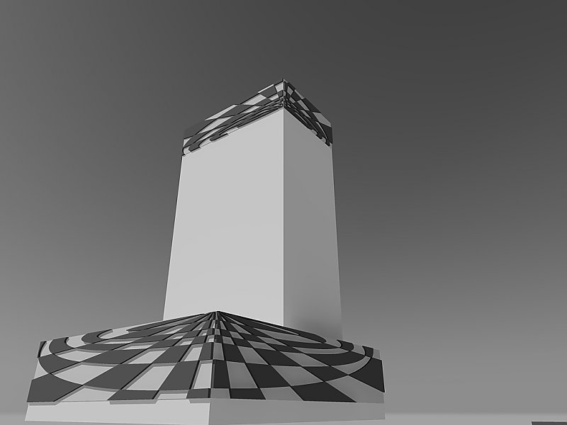

thompagr Posted February 8, 2010 Author Posted February 8, 2010 I am trying to make a facade of tower out of it... a little bit like cone with an ellipse base... I will attach the image of it Is it maybe the template faults that I use from the university (attached also) ACAD-Hu.zip Quote
