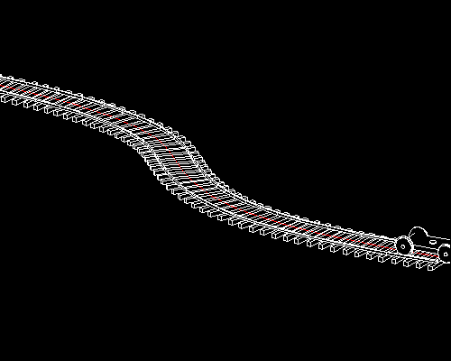

Hi all,
I'm thinking of trying to write a program that will take various points
on the dwg and automatically draw track and sleepers along those
points. (maybe use a polyline to define the path instead of
points/nodes)
Could somebody help me out here by writing the first few lines and
noting what each line does, so as i can attampt to carry it on?
This is NOT urgent, a little project for my own enjoyment/torture. :)

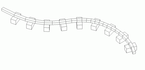

David Bethel
Do you mean something like a mono rail track?
If so, I'd probably use a spline as the path and measure the sleepers with a block. -David

skipsophrenic
Not a monorail no, train track (Railroad)
Only reason I'm even after to do this in lisp is because no matter how many times i go through various tutorials i cant seen to wrap my head arounf it.
Share this post
Link to post
David Bethel
I'd probably still approach it the same way.
You could do all of the calculations once the path was found in autolisp but it's already built into acad.
find the center line, offset the tracks, measure the center line with the sleepers, extrude the tracks if needed.
The one thing that doesn't work is dividing or measure the tracks as true wheel points during travel. The arc lengths vary so the outer wheels always travel further. -David

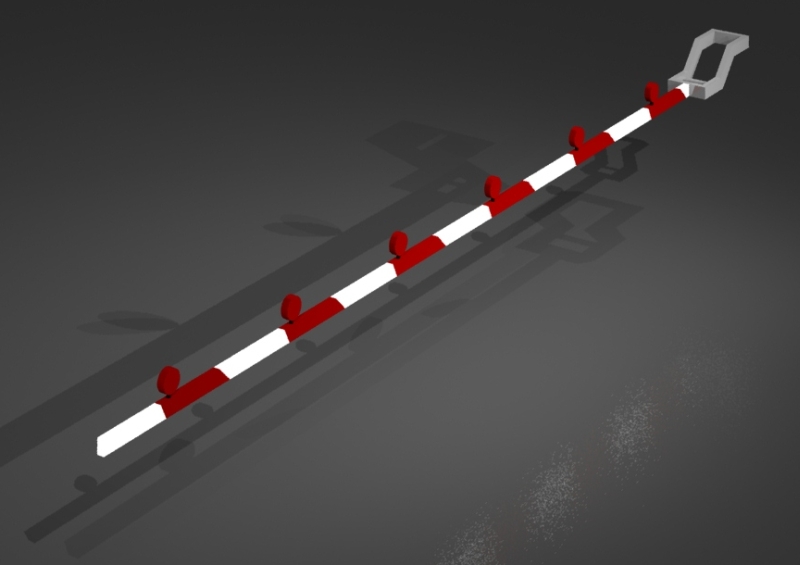

David Bethel
Here's 1 I thought would be fun. It's all in inches ( I'm just not a metric guy )
(defun c:gate (/ hgt len qty sp xp maxx bn)
 (initget 7)
 (setq hgt (getdist "\nHeight To Pivot Point:   "))
 (while (or (not len)
            (< len 96))
        (initget 7)
        (setq len (getdist "\nGate Length:   ")))
 (initget 6)
 (setq qty (getint "\nNumber Of Lights <4>:   "))
 (if (not qty)
     (setq qty 4))
;;;START THE BLOCK DEFINITION
(entmake (list (cons 0 "BLOCK")(list 10 0 0 0)(cons 70 0)
              (cons 2 (strcat "GATE" (rtos len 2 0) "x" (itoa qty)))))
;;;MAKE THE COUNTER WEIGHT AND PIVOT
(entmake (list (cons 0 "CIRCLE")(cons 8 "3D")(cons 39 10)(cons 10 (list 8 0 -5))(cons 40 1)(cons 210 (list 0 1 0))))
(entmake (list (cons 0 "SOLID")(cons 8 "3D")(cons 39 4)(cons 10 (list -2 -5 -2))(cons 11 (list 0 -5 -2))(cons 12 (list -2 5 -2))(cons 13 (list 0 5 -2))))
(entmake (list (cons 0 "SOLID")(cons 8 "3D")(cons 39 4)(cons 10 (list -32.48528137 -5 6.48528137))(cons 11 (list -30.48528137 -5 6.48528137))(cons 12 (list -32.48528137 5 6.48528137))(cons 13 (list -30.48528137 5 6.48528137))))
(entmake (list (cons 0 "TRACE")(cons 8 "3D")(cons 39 2)(cons 10 (list 0 2 5))(cons 11 (list 0 -2 5))(cons 12 (list 11.17157288 2 5))(cons 13 (list 12.82842712 -2 5))(cons 210 (list 0 1 0))))
(entmake (list (cons 0 "TRACE")(cons 8 "3D")(cons 39 2)(cons 10 (list 11.17157288 2 5))(cons 11 (list 12.82842712 -2 5))(cons 12 (list 19.65685425 10.48528137 5))(cons 13 (list 21.3137085 6.48528137 5))(cons 210 (list 0 1 0))))
(entmake (list (cons 0 "TRACE")(cons 8 "3D")(cons 39 2)(cons 10 (list 19.65685425 10.48528137 5))(cons 11 (list 21.3137085 6.48528137 5))(cons 12 (list 32.48528137 10.48528137 5))(cons 13 (list 32.48528137 6.48528137 5))(cons 210 (list 0 1 0))))
(entmake (list (cons 0 "TRACE")(cons 8 "3D")(cons 39 2)(cons 10 (list 19.65685425 10.48528137 -7))(cons 11 (list 21.3137085 6.48528137 -7))(cons 12 (list 32.48528137 10.48528137 -7))(cons 13 (list 32.48528137 6.48528137 -7))(cons 210 (list 0 1 0))))
(entmake (list (cons 0 "TRACE")(cons 8 "3D")(cons 39 2)(cons 10 (list 11.17157288 2 -7))(cons 11 (list 12.82842712 -2 -7))(cons 12 (list 19.65685425 10.48528137 -7))(cons 13 (list 21.3137085 6.48528137 -7))(cons 210 (list 0 1 0))))
(entmake (list (cons 0 "TRACE")(cons 8 "3D")(cons 39 2)(cons 10 (list 0 2 -7))(cons 11 (list 0 -2 -7))(cons 12 (list 11.17157288 2 -7))(cons 13 (list 12.82842712 -2 -7))(cons 210 (list 0 1 0))))
;;;MAKE THE LIGHTS
(setq sp (/ len qty)
     xp (* sp 0.5))
(repeat qty
 (entmake (list (cons 0 "CIRCLE")(cons 8 "3D-RED")(cons 39 2)(cons 10 (list xp 6 -1))(cons 40 3)(cons 210 (list 0 -1 0))))
 (entmake (list (cons 0 "CIRCLE")(cons 8 "3D-BLACK")(cons 39 1.5)(cons 10 (list xp 0 2))(cons 40 0.5)))
 (setq xp (+ xp sp)))
;;;THE ARM STARTER SECTION
(entmake (list (cons 0 "SOLID")(cons 8 "3D-WHITE")(cons 39 2)
              (cons 10 (list 0 -2 -1))
              (cons 11 (list 0  2 -1))
              (cons 12 (list 2 -2 -1))
              (cons 13 (list 6  2 -1))
;;;THE RED AND WHITE STRIPS
(setq xp 2
   maxx (- len 2))
(while (< xp len)
  (entmake (list (cons 0 "SOLID")(cons 8 "3D-RED")(cons 39 2)
                 (cons 10 (list (min maxx (+ xp 0))  -2 -1))
                 (cons 11 (list (min maxx (+ xp 4))   2 -1))
                 (cons 12 (list (min maxx (+ xp 24)) -2 -1))
                 (cons 13 (list (min maxx (+ xp 26))  2 -1))
                 (cons 10 (list (min maxx (+ xp 24)) -2 -1))
                 (cons 11 (list (min maxx (+ xp 26))  2 -1))
                 (cons 12 (list (min maxx (+ xp 48)) -2 -1))
                 (cons 13 (list (min maxx (+ xp 52)) 2 -1))
  (setq xp (+ xp 48)))
;;;THE END CAP
              (cons 10 (list (- len 2)  2 -1))
              (cons 11 (list (- len 0)  2 -1))
              (cons 12 (list (- len 6) -2 -1))
              (cons 13 (list (- len 0) -2 -1))
;;;FINISH THE BLOCK DEFITION
(setq bn (entmake (list (cons 0 "ENDBLK")(cons 8 "0"))))
;;;SET THE LAYER COLORS
(command "_.LAYER" "_C" 254 "3D" "_C" 1 "3D-RED" "_C" 7 "3D-WHITE" "")
;;;INSERT THE NEW BLOCK AT THE GIVEN HEIGHT
(entmake (list (cons 0 "INSERT")(cons 2 bn)(cons 8 "0")
              (cons 10 (list 0 0 hgt))))
(prin1))
Have Fun! -David
