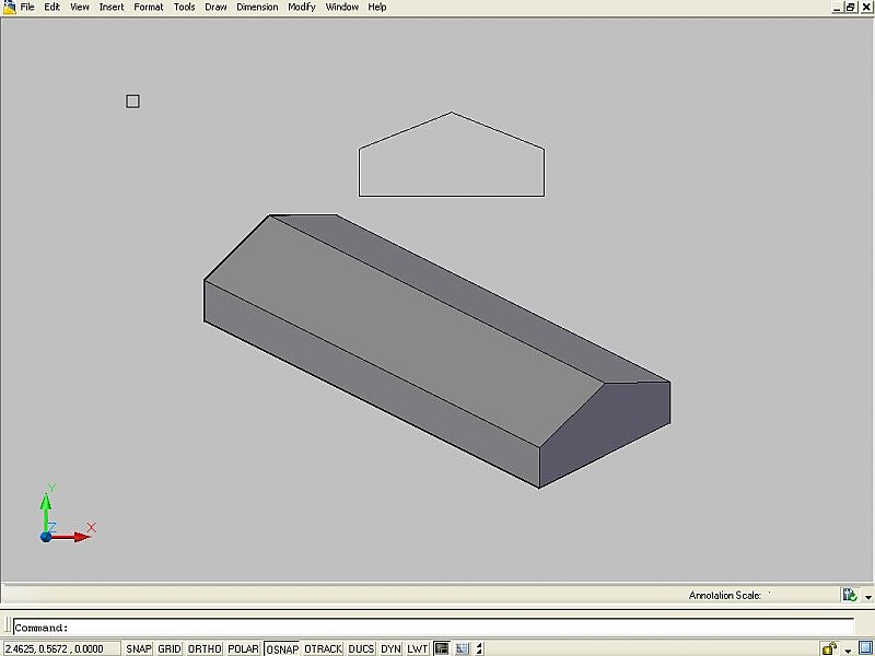

OK, I've got one of the pieces how I like it. It was a real pain to get it there tho. I saved the view of it under named views but, when I hit that view for the next one over to the right it doesn't turn into the special rotated angle I set the first one to.
You are welcome Mason.
When I first started 3D drafting I thought I had to use strictly 3D commands like 3D rotate and 3d mirror etc. Those are good commands but are a bit tricky to use at first and depending on what view you are in and what you need to accomplish....the regular 2D rotate and 2D mirror are still very useful in 3d space.
The "gizmo" you mention only appears when you use 3D rotate. If you are up to speed with that command it would be a faster way to completely get your model oriented the way you want.
I don't quite see what the angled view you have chosen (20 deg?) has over a standard isometric view. It actually appears more distorted. That's not the "look" you were trying to achieve was it? Maybe it's my monitor/video card.
I am not the best help when it comes to "Paper Space".
The way I would have to do this:
Make separate drawing files for each of your concrete models/products profile. I would only draw the profile as a closed poly line and draw it in "front view" on layer zero. By separate drawings I mean use the command "wblock". You save each molding profile as a separate drawing with "wblock" . Choose the individual molding profile and the use the "pick point" option in the wblock dialog and select the same basic point on each model as you save it with wblock. For instance...choose the lower left hand corner as your pick point for each molding profile.
To begin making the catalog items, start a new drawing and get in front view. Now command "insert block". Browse to find your first saved wblock profile and check explode and specify insertion point on screen and then click ok.
Now simply enter 0,0,0 as your insertion point. This will be the entry point that you choose for all subsequent saved wblock molding profiles.
Next....extrude the part your desired length. Copy the extruded part...select the lower left hand corner as the base point and type 0,-15,0 as your first destination point and then enter and exit the command.
Now...you are still looking at the section view of the upper extruded profile so center it with "pan" and zoom it to taste and then use "named view" to save the current view and give it an appropriate name like "profile".
Now zoom extents and find the copy profile that you placed @ 0,-15,0(the lower one on your screen).
Change views to either SW or SE isometric (your coice per taste) and zoom in on the lower model. Now use "constrained orbit" if you need to or want to in order to sweeten the view to your taste. Pan to center and zoom to taste. Enter "newview" and name this view something like "Perspective" and select current and click ok. Now when you go to paper space and make two viewports....you will be able to choose each of those two "named views" in the two different viewports at the same time.
When all is panned and zoomed the way you like in your paperspace layout, plot the layout to file or however you need to save it.
For the rest of your profiles...you need to either change the properties of the current molding profile/profiles to an off layer or otherwise move it or delete it from the current position/positions (0,0,0 & 0,-15,0).
Now you simply insert the next saved wblock molding profile drawing at 0,0,0.
Do the same extrude and copy to @0,-15,0 to each one.
Now when you go to your layout tab in paper space, your new molding will be there in the two viewports and the rotated view is automatic for every new profile.
Let me know if any of that is unclear.

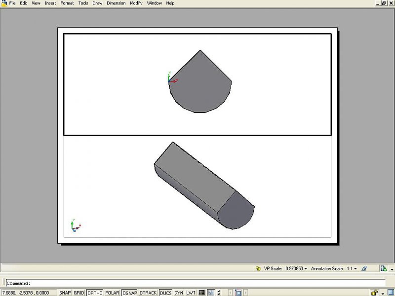

Here is the first layout with a molding profile brought in to "front view" as a block /pick point lower left corner/exploded.
I entered 0,0,0 for on screen point specification in model space.
I extruded the profile to 11 inches and copied it once to (@ 0,-15,0) using the lower left corner of the block as the "base point" for "copy".
I zoomed in on the upper extruded profile on my screen in front view and panned to screen center/zoom to taste and save as named view "profile".
I then switched to SW isometric view and zoomed in on the lower copy of the extruded profile. I used "constrained orbit" to adjust it a little to my preference and then panned it to screen center and zoomed to taste. I then used the "newview" command to name this view "Perspective".
In my layout I selected the two named views ...one in each of my two viewports.
Here is how it looks:

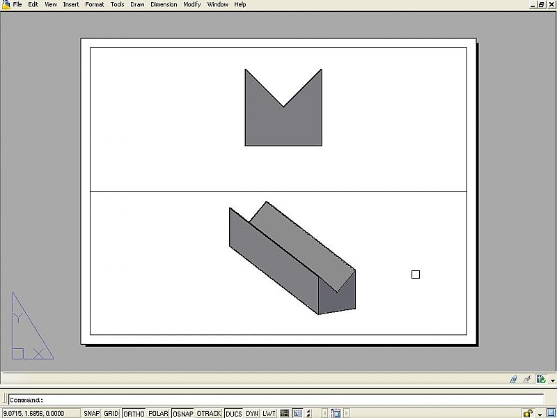

Part Two:
Now I saved that layout to file and returned to model space and choose "front view".
I used the move command to move the first models out of the way(move them to a different area).
I enter "insert block" and browse for the next profile. I select the next profile drawing and explode/specify insertion point on screen/click ok. ( When the block was made,the profile drawing block was saved with "wblock" and the lower left corner was chosen as the "pick point")
I then entered (0,0,0) and hit enter.
I extrude the new profile to 11 inches and then copy it once to the coordinates (0,-15,0) using the lower left hand corner as the "base point" for the "copy"
Now when I enter my layout I see the new molding profiles in the same two views as the first layout. This is still work but the two named views do not need to be made again.
Here is number two:
