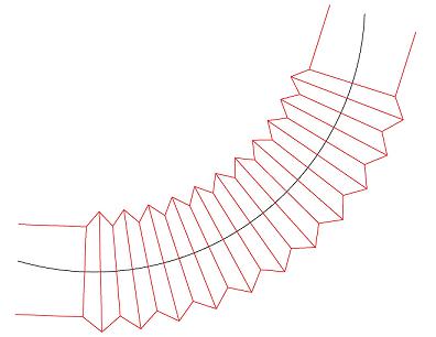

viviancarvalho Posted March 15, 2010 Share Posted March 15, 2010 We have a software add on for 2007 to draw our flexible duct in autocad 2007. I am currently upgrading to 2010, and I am not sure that this program will still work. What do other mechanical service draftsmen use to show flexible duct? I get it done by a lisp. Check out the attachment. FLEXIBLE.lsp Quote Link to comment Share on other sites More sharing options...
Lee Mac Posted March 17, 2010 Share Posted March 17, 2010 How about this? http://www.cadtutor.net/forum/showpost.php?p=147076&postcount=5 Quote Link to comment Share on other sites More sharing options...

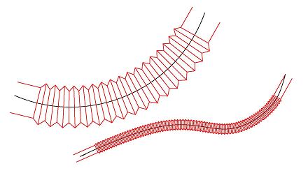

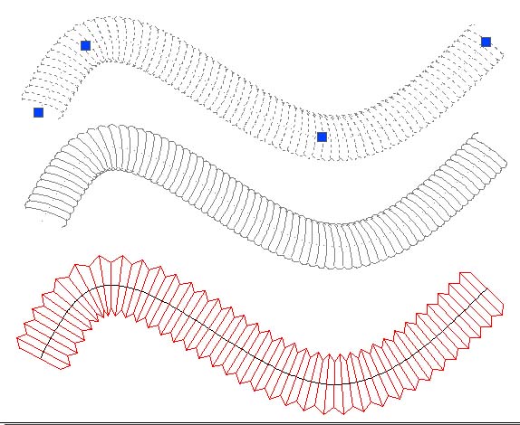

Derek Toering Posted May 30, 2010 Author Share Posted May 30, 2010 Oh happy days! Our fearless leader has decided that this flex is representation is no good. Whatever. Anyway can someone help me replicate our old one? Image attached. Current lisp is good for me in it's application. Thanks in advance. flex sample.dwg Quote Link to comment Share on other sites More sharing options...
Tankman Posted May 30, 2010 Share Posted May 30, 2010 I love this one. :wink: From Lee Mac, he speaks with a lisp. Quote Link to comment Share on other sites More sharing options...
Derek Toering Posted May 31, 2010 Author Share Posted May 31, 2010 That's what we have already. I like it but no good apparently. Can I plot straight to a jpeg from autocad? Then I can put it directly onto original post. Quote Link to comment Share on other sites More sharing options...
Tankman Posted May 31, 2010 Share Posted May 31, 2010 That's what we have already. I like it but no good apparently. Can I plot straight to a jpeg from autocad? Then I can put it directly onto original post. I print to a *.pdf then save as a *.jpg which I can adjust size for posting in the forums. A printer function is also in AutoCAD, from the dropdown print menu, select 'publish to jpeg.' Quote Link to comment Share on other sites More sharing options...
Derek Toering Posted May 31, 2010 Author Share Posted May 31, 2010 yep. hope size is ok... old flex is the basic one on right, but i like the other one called nice flex on the left top and middle. Looks nice! Got it from another forum. (swamp) If I hit boss with this one or something like it I reckon he'll be happy. (pigs might fly) Our original one looks budget I reckon. I can't get our old one to work with 2010. ( Don't really want to either just quietly) Quote Link to comment Share on other sites More sharing options...
