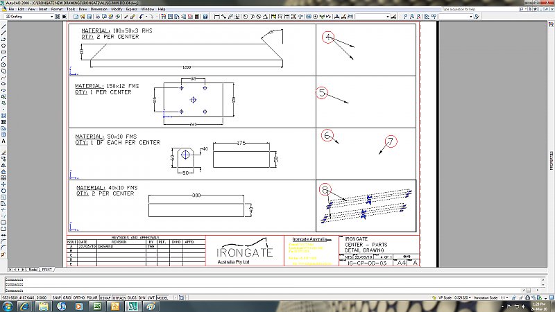

Iv'e got a problem when i use more than one viewport on one page. For example if i have one viewport showing a 2D object and the other viewport showing a 3D object, to begin with i can see the 3D object and then i save the drawing and reopen it later and the 3D object dissappears. It is still there in the MODEL space but not in paper space, but if i run my mouse pointer over the empty viewport i am able to select the object and then i can see it, but as soon as i deselect it, it dissappears again. However when i print everything comes out, its only when im in paperspace i can't see it. I can even see it in the preview window in Windows explorer when i highlight the icon. Is it somethin with my computer, AutoCAD, or is just on of those things? the problem isnt isolated to one drawing either. I've attached a screenshot showing my problem. There is spose to be 3D objects in the 4 viewports down the right hand side of the page, i have highlighted the bottom one.
You might try bumping up the value of the system variable MAXACTVP (max active viewport) and see what happens.

thanks, that seems to have fixed it :D
