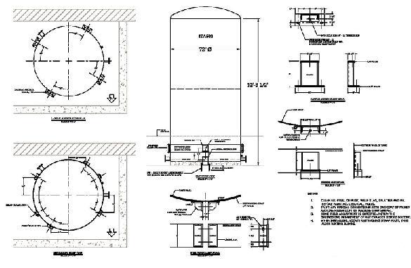

abitare Posted April 4, 2010 Posted April 4, 2010 i have many drawings in dwg but wish to upload onto my website.............how can I convert a dwg file and retain its detail so it can be the same on my web page...........hope this makes sense.............have converted dwg to jpeg tiff gifff etc but it loses detail Quote

stevsmith Posted April 4, 2010 Posted April 4, 2010 If you are looking to have your drawings uploaded to your website I would recommend that you upload them as a PDF file, this allows the user to visualise the drawing without the need to open AutoCAD or any other draughting software. PDF is viewable on all computers. I would then have an option to download the .dwg file if required. Quote

MikeScott Posted April 4, 2010 Posted April 4, 2010 You could also try the printscreen button on your keyboard, and paste it into a photoshop-type program. Just put it at the size you want to display it as, and then crop it down. That will eliminate distortion. If you want it bigger, stitch them together, or use PDF as stevsmith noted above. Quote

Tankman Posted April 4, 2010 Posted April 4, 2010 I've had great success printing to *.pdf using Adobe Acrobat Pro. The resulting *.pdf can be saved to a *.jpg or many other image formats. Works very well. Below is a downsized image, downsized to post. Difficult to read due to the reduced image size but, again I emphasize this is only for posting. Quote

f700es Posted April 6, 2010 Posted April 6, 2010 Well you have to remember that all those formats are pixels and will never be as sharp as a vector image. Maybe have a jpeg as a thumbnail and then have it link to a PDF. i have many drawings in dwg but wish to upload onto my website.............how can I convert a dwg file and retain its detail so it can be the same on my web page...........hope this makes sense.............have converted dwg to jpeg tiff gifff etc but it loses detail Quote
