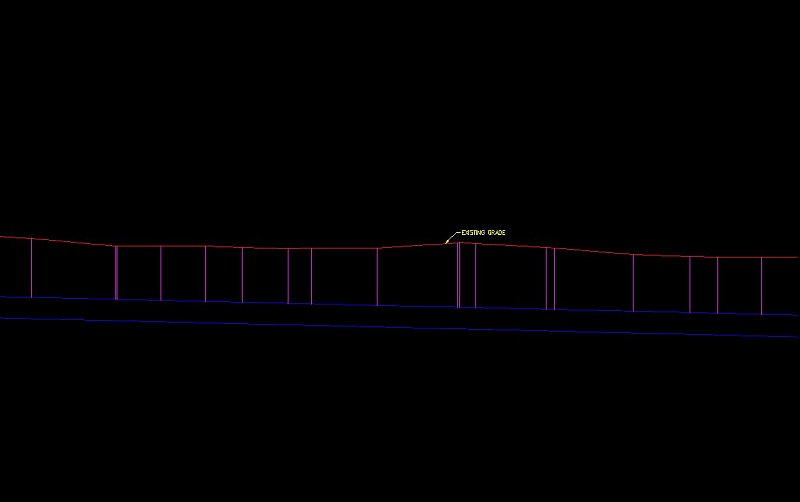

thats what I do to draw in my pipe, the only problem is that my existing grade is never just a straigth line.... Im gonna post a scree shot and explai a little more...give me a min
ok here is a screenshot of a portion of my drawing.
The two blue lines are my pipe..what i am looking for is a way to find the length of the shortest magenta line. If this needs to be in the lisp forum feel free to move it.
This line runs about a mile so I need a way to draw the magenta lines in between the red and blue lines than find the shortest one. What i did for this screenshot was just draw XLINES vertically from the endpoints of the red line than trimmed between the two...
So im trying to find a quicker way of combining those steps..
