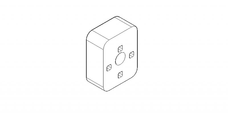

ReMark Posted May 4, 2010 Share Posted May 4, 2010 You are talking about an isometric view. In AutoCAD can isometric view can be created in 2D or 3D. 2D Isometric Start the SNAP command. Type for Style. Then type for Isometric. AutoCAD will ask you to specify the vertical spacing. Accept the default by pressing the Enter key. Look at your screen. The crosshairs will now be foreshortened and in two colors (green & red). Press the F9 key to turn off Snap. Pressing the F5 key will toggle the three isoplane directions of Top, Right and Left. 3D Isometric This would require the creation of your object in 3D and a change of view (one of four preset isometric views. The 3D solid object is created from 2D geometry. Quote Link to comment Share on other sites More sharing options...
ReMark Posted May 4, 2010 Share Posted May 4, 2010 Here is an example of a simple isometric. Note that to create a circle in an isometric drawing you do NOT use the Circle command. Use the ELLIPSE command instead. Start the Ellipse command. AutoCAD will prompt you to Specify axis endpoint of ellipse or [Arc/Center/Isocircle]: Type for Isocircle. Next you'll be prompted to Specify center of isocircle. Pick your centerpoint. Then you'll be prompted to Specify radius of isocircle or [Diameter]: Input a radius or type for Diameter and then enter a diameter instead. The result should be an isometric circle. Quote Link to comment Share on other sites More sharing options...

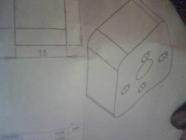

endlasuresh Posted May 4, 2010 Author Share Posted May 4, 2010 thanks for this too Ill draw that thing once i cleared this their are two more images i dont know whether they are top or side view etc but how we can find it.see below links of images which i posted earlier too http://img140.imageshack.us/i/31694509.jpg/ http://img443.imageshack.us/i/66554365.jpg/ let me know how to find the thickness and draw final product too. Quote Link to comment Share on other sites More sharing options...
ReMark Posted May 4, 2010 Share Posted May 4, 2010 I did not ask you to draw the above image. I posted it so you could see what an object might look like drawn in 2D isometric. One image is a side view. It shows the depth (thickness) of the object as 15. I could not open the second image. What do you mean "how to draw final product"? Do your three standard views and add the isometric view as the fourth one if you want. I already gave you instructions on how to go about drawing in 2D isometric above. Quote Link to comment Share on other sites More sharing options...

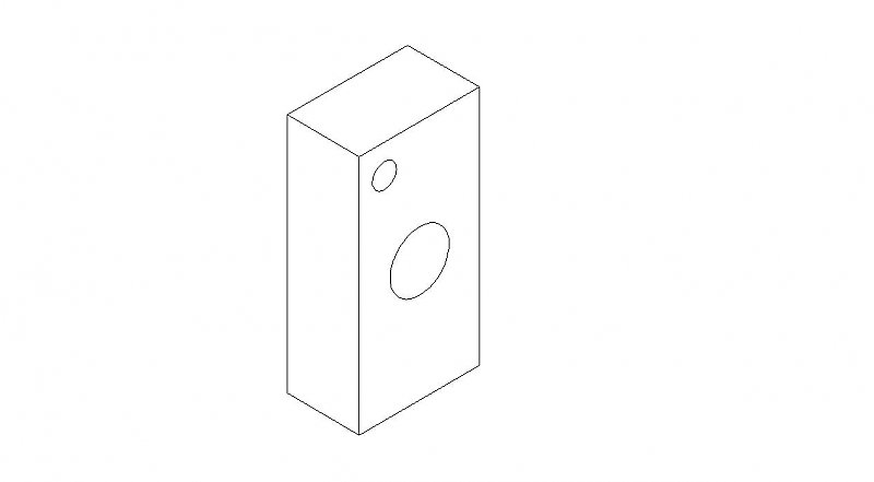

ReMark Posted May 4, 2010 Share Posted May 4, 2010 Something to look at. SE Iso view of your part done in 3D. Question: Do all the holes go completely through the part? Quote Link to comment Share on other sites More sharing options...
endlasuresh Posted May 5, 2010 Author Share Posted May 5, 2010 they have given this much but from my side yes the holes will go completely through the product. Ill draw the second image too and will post in the next post. here are few questions did you used the plan view measurements or image to draw this iso view ? can we cut this product on a plate of 15mm thickness and the plate would be 60 mm in length and 50 mm in breadth or as we wish but it will the plate would be larger than the product so that it can go inside in the plate. this is for view how a die can be made.ill post some samples of the die making. Quote Link to comment Share on other sites More sharing options...
ReMark Posted May 5, 2010 Share Posted May 5, 2010 I anticipated that the holes would go entirely through the object and drew it as such. It was only after doing so that I had some doubt. That is why I asked. I used the plan view measurements. The object's thickness was taken from one of the images. Your question about the plate makes no sense to me. I do not know what you are asking. Sorry. Are you asking if a punch can be made that would produce this piece out of flat stock (plate)? Quote Link to comment Share on other sites More sharing options...

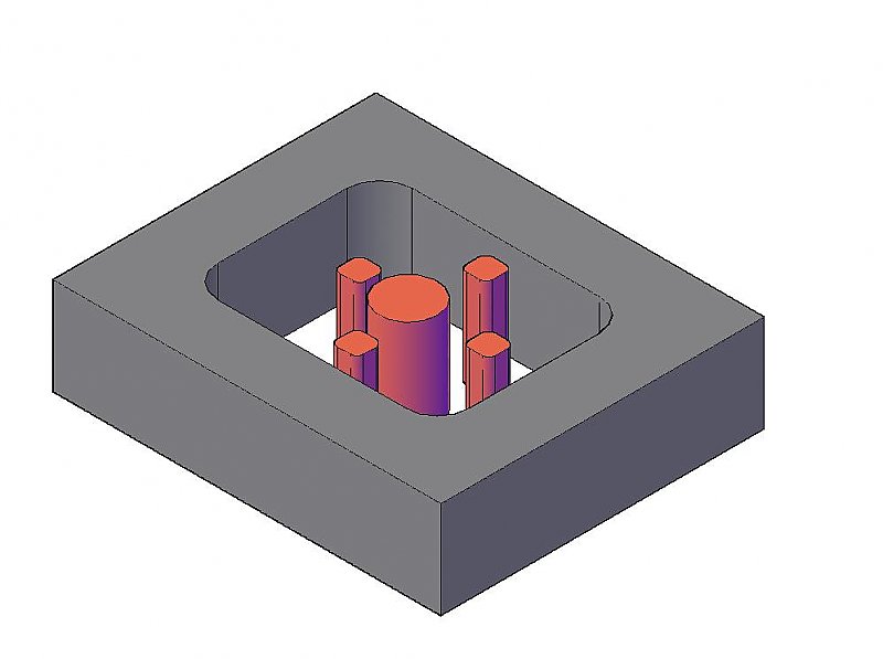

endlasuresh Posted May 5, 2010 Author Share Posted May 5, 2010 thanks its fine for this iso view using measurements.I thought it was made like for preview without measurements here what i was requesting means the product which is in iso view i have to manufacture it with plastic or rubber so we need to cut the shape on iron plate. as you say it can be done by punch yeah the product should be punched on the plate.the plate will be larger than the product but not the die. A die means where the cavity should be made for product.it consists of several plates holes rods etc. here is the sample black is metal plate red squares and circle are all 15 mm thickness white space should be empty space so we fill in this white space with plastic or rubber to make that component.I want to view this in iso view so i can understand how does it looks inside the die.This is an easy to make but most components needed to be cut in several parts. I hope you understood what i was asking but if cant tell me i can show sample of our other dies. Quote Link to comment Share on other sites More sharing options...
ReMark Posted May 5, 2010 Share Posted May 5, 2010 Once again I am at work and unable to view an image (if you did include one in your post above). I won't be able to answer your questions until I arrive home. Quote Link to comment Share on other sites More sharing options...
endlasuresh Posted May 5, 2010 Author Share Posted May 5, 2010 I think this forum has some problems in attaching images.I have tried previously to add an image but when i insert link it doesnt show image at all. here is the link if you can see or ill try use another imagehost http://img338.imageshack.us/i/sampl.jpg/ Quote Link to comment Share on other sites More sharing options...
ReMark Posted May 5, 2010 Share Posted May 5, 2010 Is this what you're looking for? Quote Link to comment Share on other sites More sharing options...
