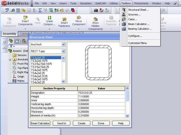

cmjay83 Posted May 4, 2010 Posted May 4, 2010 Hi is there anyplace I can download some weldment structural members, I have been on 3d content central and cannot find any SHS (Square hollow section/Tube) I have found RHS + CHS. Many thanks Quote
shift1313 Posted May 4, 2010 Posted May 4, 2010 You can get structural members from the toolbox. The tool box can be turned on from Tools>add-ins (if its not already). Quote
shift1313 Posted May 4, 2010 Posted May 4, 2010 If you click create, it will make a 2d sketch of whatever you chose. You can then use that to extrude or sweep a path to make your structural member. Quote
