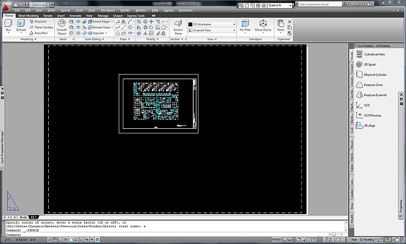

I see you have placed your viewport on the defpoints layer. I've done that is the past myself but I would recommend you consider creating a non-plotting viewports layer.
You have a rather large frame on layer _Refline. It appears to measure 42x30. What is this for?
Your paper size is quite a bit smaller. Roughly 34x22. Why?
The viewport you created is not locked. I highly recommend you lock your viewports when you have them set up the way you want. It is too easy to mess them up inadvertantly.
By the way, I had no trouble going into model space and then back out.

I was able, without any difficulty what-so-ever, to do a Zoom > Extents within the single viewport of the drawing you emailed me. Perhaps you did not double-click inside the viewport itself first. This puts you in the model space environment. When I did it, I was able to see the entire floor plan as well as the titleblock and border.
As regards your own titleblock and border I would recommend inserting it in your layout. Of course, I am assuming your TB&B are drawn at 1:1 scale (full size). Normally one would size the paper used in the layout such that it was accommadate one's TB&B. Some tweaking may be necessary.
Note: Anything that fits within the dashed lines that you see will print. Anything outside those dashed lines will not print. Consider that area to be akin to the dead space usually seen around the outside of a TB&B. Make sense to you?
And by the way, your plot scale will be 1:1. AutoCAD will know how to plot the viewport based upon the scale you assigned to it.
Now, go forth and plot. Good luck.
Proof I was able to do a Zoom > Extents. You'll notice that I erased the frame and any text that was outside of what would be considered the paper.
The first set of solid lines inside the dashed lines would be the viewport frame. The titleblock and border can be seen within.

OK, I just inserted the T-block into the layout (black area inside the dashed line). Nice. ReMark, I just deleted that frame you pointed out and a few pieces of stray text that were in the gray area outside the layout and everything is now zoom extents. It was that frame holding it back. You can hardly see that frame on the gray background, but it's gone now and all is well. Will now plot with the border inserted as well. This is great progress for me. It all makes sense now. Can't thank you enough, as always.
