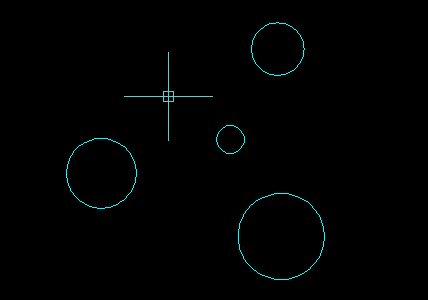

Hi !I'm not sure if that's the right section to post my issue but i'll write it anyway.I'm newbie when we are talking about AutoCad,Lisp stuff.
So my problem sounds like that:I have to generate a Lisp function which interconnects all my circles from model space.That's it.

What do you mean by 'interconnects'? Draw a line between the centres?

@Lee Mac What i need is: drawing a line that connects borders of the circles,not centers.
@Tankman Thank you !I'm posting from Romania.
@Alanjt The last example seems better than the first,but as i said,the lines must connect the borders not centers.Anyway giving me the code for the last exemple would be great.
Thank you.
Are you trying to connect each circle with a tangent line?

Wouldn't connecting circles via tangent lines require the user to be more precise with their picks? I line could be tangent to a circle in any number of places right?
It might be helpful, as you point out Alan, if the OP gave us an idea of the number and configuration of the circles. One other thing he fails to mention is if all the circles are the same size or do they vary?

Let's see:The result should look like the one in the alanjt's 5th post,but the lines inside the circles should not be visible.That's all.

5th post? All I did was connect a group of circles (by insertion) with lines. If the lines were removed, you'd just have a bunch of random circles.

Am I off the mark?
(defun c:cc ( / ent cen rad gr code data d ang tan iAng tmp )
