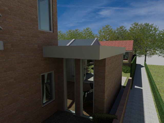

I know this document, and it's not what i mean. I know you can use a foto for the background. See, my previous project:
But i want to try and create clouds in this picture:
I'm thinking about half a dome that's transparent and has a few clouds on it...
Okay,
I tried to do what you said, but don't forget, I work on AutoCAD 2011, and there's the function of the sky and the Illumination of it. This works perfectly when no background is selected.
But when a background is selected I got this:
The sun is working, but the illumination is not!
Why, in the image a few posts back the sun is good, it's the same camera view, only with a background in stead of the sun & sky background...

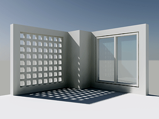

Well, you're right Damo. Background images and sky lighting don't go hand in hand.
But again, there is a workaround. You can use any image editing software (like Photoshop) to add the sky and other backgrounds AFTER you have rendered the scene. To make things simpler, let me present a way to do so...
1. Render your scene with Sun and Sky lighting (indirect illumination) turned on. Save the image.
2. Now, turn OFF Sun and Sky lighting.
3. Type in RPREF (Advanced Render Settings), turn OFF Shadows, Ray Tracing, Indirect Illumination, Final Gather.
4. Render the scene.
5. Save the image as a PNG - with 32 Bits (24 Bits + Alpha) option checked.

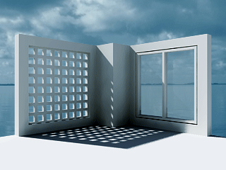

6. Open the first image in Photoshop and use the second image (which contains Alpha information) as its Layer Mask. It would look like this...
7. Now use your "cloudy" background under this layer. :wink:
8. Done!
Note that it even works for transparent materials (as the window on the right side). :geek:

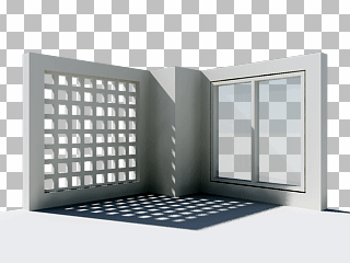

Nice tip there fahim. deserves a star! :D I'm not very good in photoshop, why do you need the second image as its layer mask?
...why do you need the second image as its layer mask?
To add transparency! ...lol. :lol:
Basically, the program uses the alpha channel of the second image and applies it on the first one. This way, the default Sky background (that you see when rendering with Sky Background and Illumination option checked) can be replaced by any image of your choice without manually selecting and deleting areas... note the level of smoothness you get at edges! :geek:
If you save the first image as 32 Bits PNG, you won't observe any transparency. This is because it has already been flattened by AutoCAD while rendering the sky background. :)
Hi Fahim,
This is a excellent trick! I thougt of it when seeing the option 32bit, but there was no alpha :( Step 2 was the answer for that difficulty. :)
i'm going to try that and show the result here!
Thanks again!

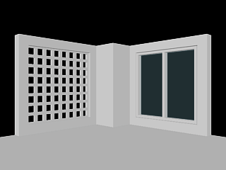

So, I'm starting with that:
Then I'm rendering like you said without some options:
And when put mask 2 to pict 1 it becomes:
