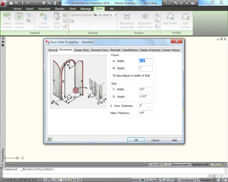

The dimensions tab. There you will find all the stuff to modify the sizes of many items. The one you are looking for is frame. I usually have the frame width set to "auto adjust to wall thickness" checked unless there is a specific condition (brick ect.) that requires it to be set otherwise.

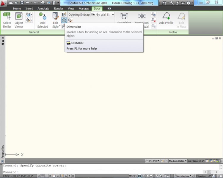

Hi Noahma,
I don't see it. I see in the General tab, Dimension icon (DIMADD). When I click on the DIMADD, the left popout window comes out. That's the same as right clicking on the door and selecting Properties.

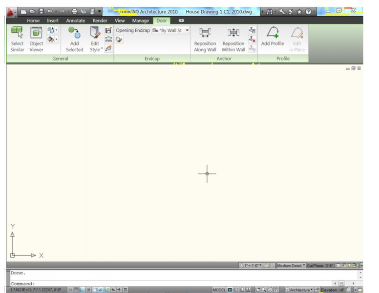

I'm in the 7th tab, Home, Insert, Annotate, Render, View, Manage and Door which only shows up when I click on the door and is green.
There's 4 ribbons, General, Endcap, Anchor and Profile.
The dimensions tab will be in the edit style window.
The drop down menu only has Edit Style, Door Style and Profile Definitions.

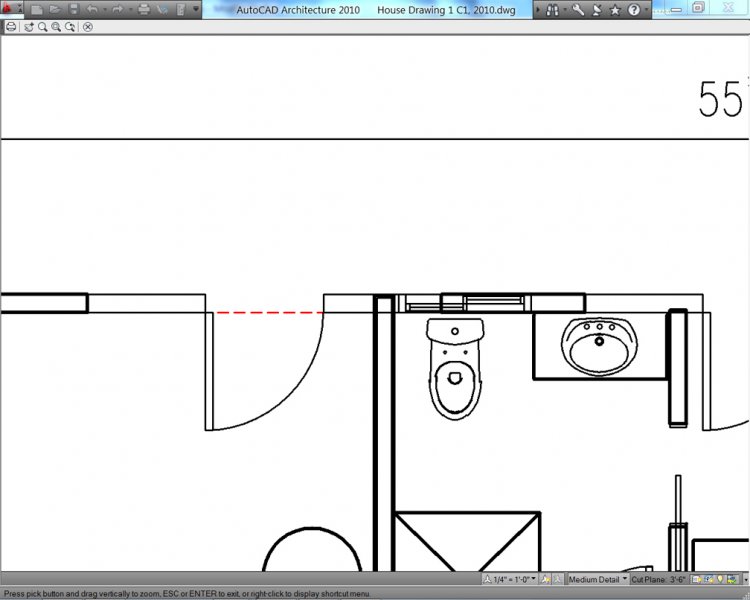

The Edit Style icon (DOORSTYLEEDIT) does have a window that's called "Door Style Properties - Standard" and in the "Dimensions" tab, I already checked "Auto-Adjust to Width of Wall" but didn't correct it.Door option 4.jpg
looks to me like it is a cut plane issue. Can you post a copy of part of the file?
Change your frame width, or do your doors have a 2'-8" frame width? Our welded frame has a width of 2-1/4"
