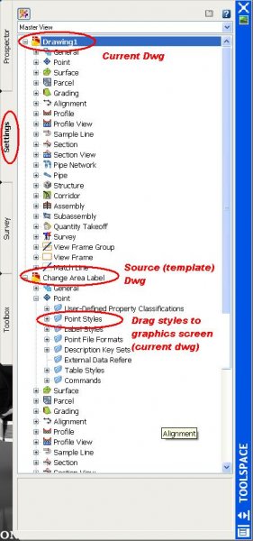

lpseifert
Open both files. Make the client dwg current. From Prospector you can drag the styles from the Settings tab of the source file to the graphics screen of the client's.
Edited by lpseifert
added image
