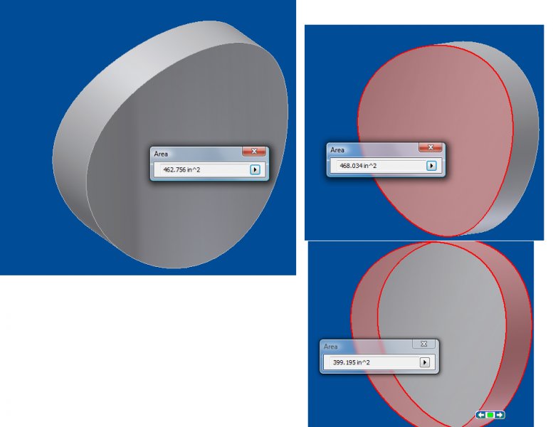

JD, going over my numbers it appears that the area number you show is the tota surface area.
You also appear to be using the weight of water for the density.
Could you also verify these numbers in addition to the requested numbers?
Surface area outside: 462.76 in^2
Surface area inside: 468.04 in^2
Link to post

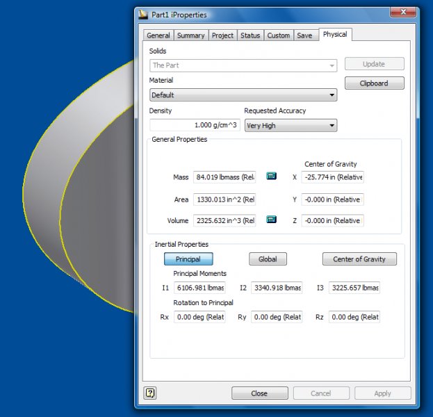

I got 2327.04 cubic inches integrating.
Looked like a typical question on Inventor certification exam. (I used Autodesk Inventor - students can download for free from http://www.autodesk.com/edcommunity )
(This could also be done in free to everyone - Inventor Fusion http://labs.autodesk.com )
Less than 5 minutes "work". Circle (3 times, one for each given size) Extrude, Extrude - Intersection. iProperties. Done.
I left on the default of density which is water.
Area is of outside faces of removed solid. Not sure what other area you are referring to?
Link to post
The two areas I was asking for are the areas on for each "face". There is also the area around the object (5" wide strip) that has a surface area but I am not concerned with that.
Thanks again! Those should measure exactly as your program could give.

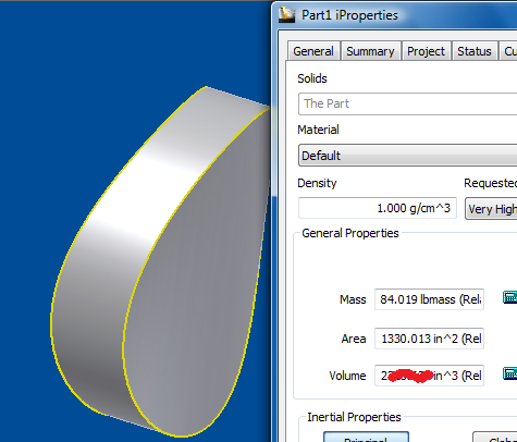

Thank you yet again. You will notice that my numbers were spot on for the face area's. It seems I need to integrate the entire way through the wall to get a precise number. My face area's were averaged and then multiplied by 5" for the wall thickness. It's very, very close, but not exact. I still need more work.
Thanks once again.

It takes a triple integral to get both surface areas and volume.
It was run on a university computer lab (read big time university math lab) and here is the answer exact to four decimal places. I am posting this just for interested parties. 2325.6232 cubic inches.

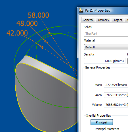

JD, I really hate to ask but can you repeat this for a hole that would be 42" in diameter intersecting the same cylinder with a 48" ID and 58" OD?
With a parametric program like Inventor simply edit the dimensions and the model updates.
Students and faculty can download Inventor Professional for free.
